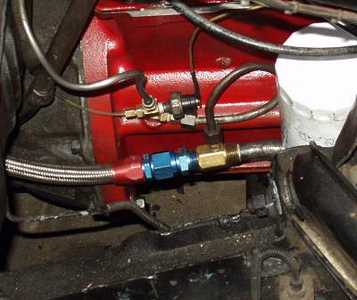

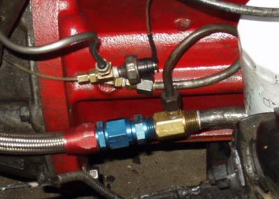

The install was pretty easy. I ran a piece of 1/2 inch pipe (3/8 npt thread) right out of the oil pump and used some fittings to connect it to the flexible braided hose.
Fittings and Connections

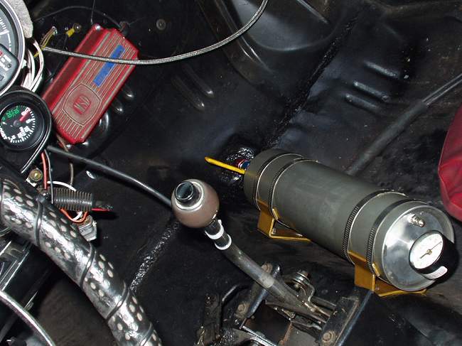

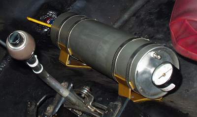

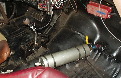

Once I saw where the braided hose wanted to go through the firewall, I drilled a hole and that lead me to the place where the mounting brackets needed to be. 4 holes later and the unit was installed.
Mounting Brackets
With all the extra fittings and connection points, I was worried about leaks but as luck would have it, no leaks upon startup.

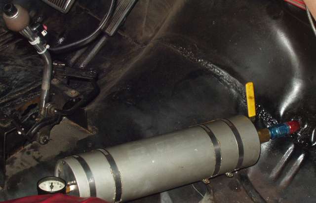

With the unit mounted next to the shifter, it is easy to reach over and open / close the valve.
It sure is nice to be able to start the engine with oil pressure already showing on the gauge.
