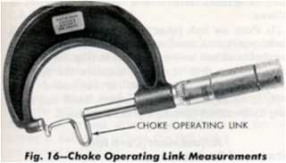

You will notice that when the flap shuts, a linkage rod pulls the "staircase cam" onto a fast idle setting. With the choke flap fully closed the choke's fast idle adjusting screw should be on the highest cam step. The position of the fast idle cam can be adjusted by bending the "L" shaped rod leading down to the cam.
The next step is to start the car and watch as the vacuum pod
pulls the choke flap open. This should allow the cam to drop down to
a lower step and reduce the fast idle speed a bit. If this does not
happen then check to see if the vacuum pod is bad or of the linkage
is binding. During the first few moments of starting the car, try
opening or closing the flap a small amount by hand to see if the
engine runs better. If it does, you need to adjust the
"U" shaped "operating link" shown above. (large arrow) Opening
the "U" wider will keep the choke closed and up on the higher
steps of the fast idle cam. Squeezing the "U"
shut
will open the flap more and drop the fast idle cam to a lower step /
slower idle speed. This is a key adjustment and bending the choke's
operating link a small amount has a major effect on over-all choke
performance. The factory used a micrometer to make this
adjustment!
