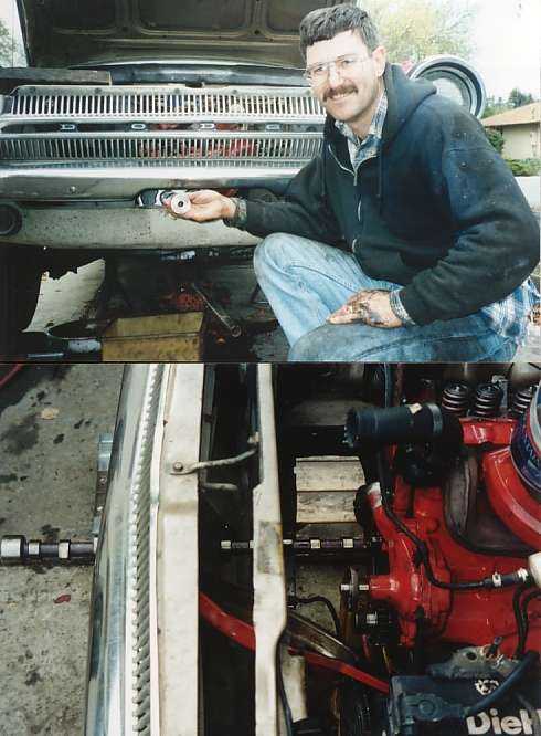

I can say that it is possible to change a camshaft in a 63-64 Dodge Dart because I have personally done that job.
With all Slant Six cam installations, the push rods, lifters, as well as the distributor, oil pump and fuel pump must be removed. The parts in front of the cam must also be removed. In reverse order these are the timing gears, timing chain cover, damper, fan, pulley and radiator. With the 63-64 Darts, the license plate must also come off.

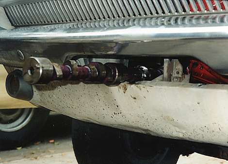

I had to raise the engine a few inches so the cam would slip through a narrow gap in the Dart's gravel pan. I removed the big nuts at the bottom of the engine mounts and lifted the engine with a floor jack.
Note that a SL6 camshaft is 25 1/2 inches long so you can get a good idea about the room you need for the job by cutting a stick to 24", then holding it up to the center of the "X" stamped into the timing chain cover.
The cam can be slipped through the cut-out in the gravel panI can say that I could not do this in- car cam change on my 65 Dart unless I removed the gravel pan. I bet the job could be done on a 66 Dart but the bumper may get in the way. (I've not done one in a 66 but it looks OK.)

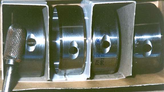

Slant Six cam bearing grinding for better oil flowSo, just in case you want to install some cam bearings with that cam, here is a little prep. trick I use to get a little more oil down to the crankshaft. (Remember how the block's oil passageways down to the crank are partially blocked by the cam bearings?)
You really need to pull out the engine if you want to change the cam bearings.
