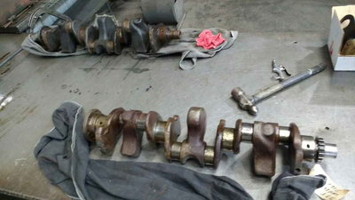

And two small torque converter cranks:
File comment: Two small torque converter cranks
