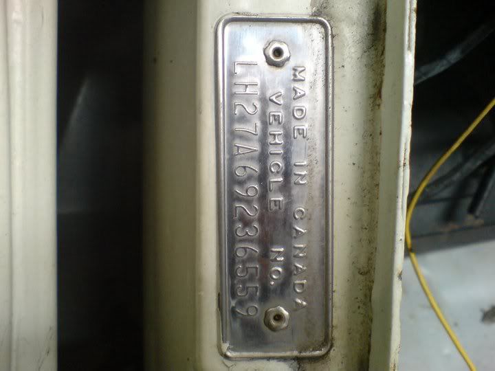

Hi there.
Im wondering if anyone here can help me out.
As you probably already know, Im from Malaysia, and I have a 1966 Dodge Dart 270 Convertible.
My problem is the car registration card has some wrong infos:
Car Manufacturer : Dodge (Correct)
Car Model : Custom (WTF!)
Year of Manufacture : 1966 (Correct)
Engine size : 3687cc (The car has the original engine, and its a 170ci (2.8L) not the 225ci (3.7L)
VIN : LH27A69****** (According to the VIN, "A" is for 170ci which is the engine that is in the car. And the VIN number on the car and the card are the same)
My problem is trying to convince the local DMV (who knows NOTHIN' about Mopar) that they made a mistake and that the reg card should say "Dart 270 Convertible" and the engine size should be "2786cc".
All I have rite now are the "Service Manual" which says that "A" is for 170ci, the VIN Decoder program (off the net, which I dont think they would believe anyway), and the engine number itself, which is 170 11 24.
They would need some sort of a letter/email from the "Authorities" i.e. Chrysler saying that the engine in the is per factory and the engine size should be 2.8L instead of 3.7L.
Who should I write to? I dont think Chrysler would even wanna listen to my problem... Sad
Any ideas?
PS: Sorry for the long post. Hope you get what Im trying to say.

Post subject: (Sun Oct 30, 2011 6:46 am) Reply with quote
Around here asking to change a registration is tantamount to pissing in yer own corn flakes. ....more trouble than its worth.......
In Canada your car model might well have been a Custom 200.
If the VIN matches the facts I would leave well enough alone.

Post subject: (Sun Oct 30, 2011 1:17 pm) Reply with quote
Syed may be taxed on engine displacement… Smaller is less punitive.
Second symbol in vin = price class. USA or domestic, not for export vehicles, had the following designations:
E= Economy, M= Middle, H= High, S= Special, and P= Premium
In USA your 270 would have M as second symbol I believe. Export and or vehicles built off shore may have used different coding for price ranges from US coding.
Also these codes were changing every few years in mid to late sixties before a standard format was developed.
Dan can probably enlighten us about this detail.

There was no "M" for the A-bodies. L for Low, H for High, P for Premium. Also no difference between domestic and export coding of this detail.
Mmm...nope, the VIN format in question was fully implemented in 1966 and remained the same through (and past) the 1976 end of A-body production.

WAS built in Windsor, Canada
Probably why the model is Custom. Your car looks like a Canadian Custom 200.

Post subject: (Mon Oct 31, 2011 8:47 pm) Reply with quote
Says on the VIN plate too (Made in Canada)
