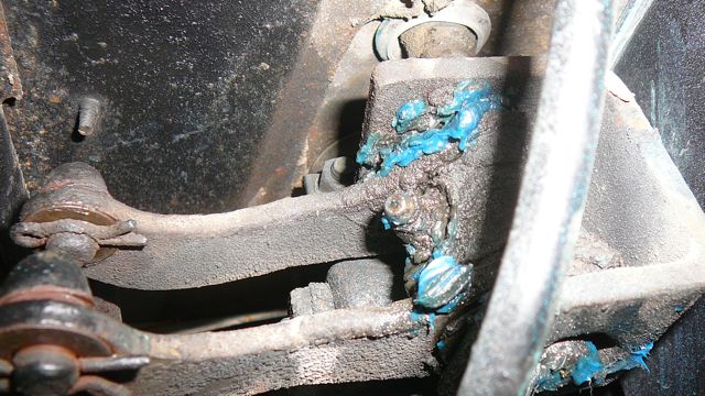

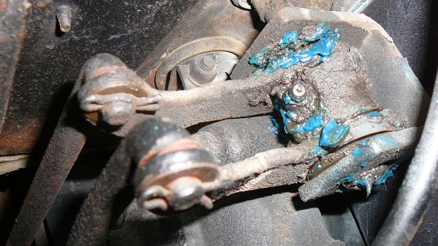

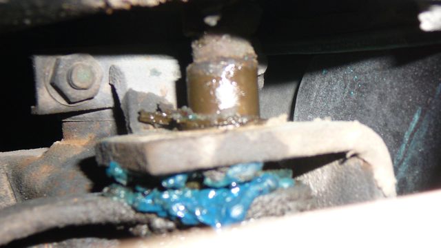

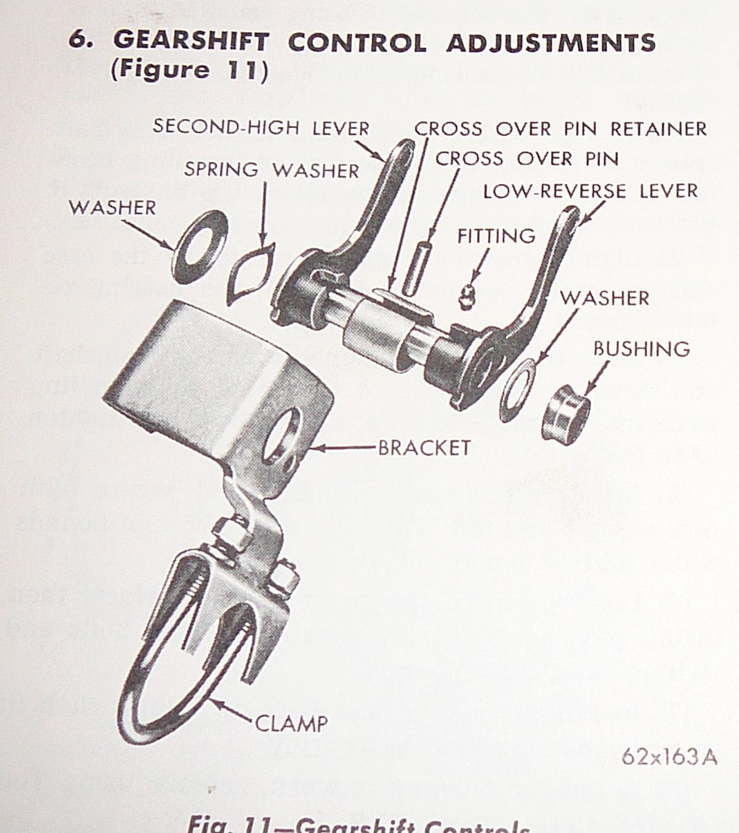

I also have a 903 transmission with 3 on the tree column shifter in a Dodge A100 1965, the gearshift control adjustments bushings are toast and the whole linkage is loose. The shifter is working, but I would like to replace the bushings or the whole package if a rebuilt was available.
I need help to find one of two possible solutions:
1) find a complete setup or a rebuild kit with new bushing, washer, fitting, pin and pin retainer, spring washer and regular washer.
2) take it apart and machine new parts
Please let me know of any suggestions on replacing or improving this linkage and tightening up the linkage.

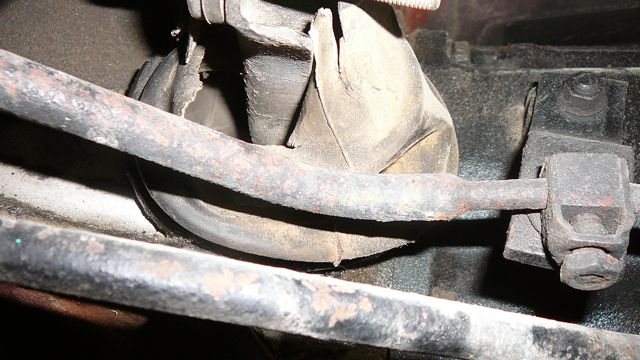

I am also interested in a transmission cover boot.
903 linkage photo in service manual
current linkage
missing bushing
transmission boot
The a100 van is otherwise in near perfect stock condition.

Well, the closest thing I could find locally for the upper linkage bushings was washers and a nylon spacers/bushings. They need a little futzing with but I'll use them for now.
The lower ones were pretty floppy too but they don't look like they were designed to take a bushing so I might just tighten them up with washers.

I was thinking the same thing, nylon bushings and stainless washers. Just wondering if the crew here thinks that's reasonable?
I noted the column shifter was manufactured in the the 60's through 88 so there must be parts available for the bushings? bushing parts numbers?
Could you describe the bushings, size, is there just one at the post moving up and down or are there others on the main shaft of this mechanism? I have nothing left but metal and it's very loose?
I am concerned that if I take it apart the whole thing will go to pieces and never go back together? Dan, Chuck, Doug? Bueller? help?

Shelby, I'll take pictures of everything when I put it back together. I have one complete OEM bushing, spacer, and washer setup, the rubber bushing is t-r-a-s-h-e-d but it let me pick the the nylon bushing out easier. Got it at my local OSH hardware.

There is nothing "high tech" with these shifter assemblies... they are just made of "cheap" materials that were never intended to last this long.
Make some notes & take photos as you take things apart, then find, make, rework the parts needed to fix the worn-out or broken pieces you find.

Is there a part number on the OEM hat bushing and spacer washer?
Where is the rubber bushing? Is it around the center post?
