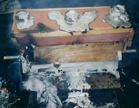

Let’s review what I know about how the cast iron SL6 blocks were made, namely the sand casting process. In the process of producing the "Dutra Dual" cast iron dual exhaust manifolds and the aluminum Hyper Pak intake manifold, I have become quite familiar with this type of casting process.
Sand CoresThe RGFC blocks were cast 2 at a time, in a single sand mold made up of a cavity "rammed-up" into a box of "green sand", with several sand cores added, which create the hollow sections of the casting. The blocks were cast camshaft side down, crankcase to crankcase. Each mold cavity was loaded with over 20 "cores" made of baked oil sand. The major cores formed the crankcase, the cylinder deck-bores-valve tappet chamber, the water jacket, and the front and rear of the block. The main bearing webs and the crankcase pockets were made for both blocks by 3 large cores assembled together. The core that forms the front bay of one block forms the rear bay of the other, in other words, each end core formed the water pump scroll and the timing chain cavity on one block and the rear bell housing flange on the other. The water jacket cores were assembled to the crankcase and barrel slab cores using core wires. After the small cores for the fuel and oil pump pads are placed, the crankcase / water jacket / barrel slab core assembly was lowered into the outer sand mold and then the end cores were added to hold everything in place.
Barrel Slab Sand CoreAfter all the cores were set in place, the mold was "closed" with the top half of the outer cavity mold. 3 water jacket "venting holes" per block allowed hot gas and steam to escape through the top of the mold. These holes along with 4-cored holes in the cylinder deck were used to shake out the core sand after casting. Later blocks saw 2 more "venting holes" added to each block (5 total). These gas venting / "shakeout" holes are the ones we commonly refer to as freeze plug holes.
The mold was closed and poured. If everything was done right, out would come two SL6 block castings, ready to be cleaned & machined. Now that you see how all these cores were individually made, assembled and loaded into the mold, you may have a better idea of what the term "core shift" is all about. Core shift can be caused by poor core placement in the mold or the cores might move or "float around" when the molten iron is poured in. Either way, you end up with a casting exhibiting uneven wall thickness. Remember, the block is lying on its side so core shift will usually result in the cylinder walls being thicker on one side of the bore than the other. This situation can cause cylinder wall distortion or failure, especially if the block has been over bored by a large amount. The relative thickness of cylinder walls is usually thought to be the most important aspect of block selection.

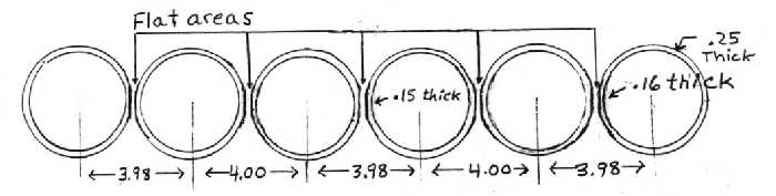

An important piece of information to collect now is the alignment of the cylinder head’s combustion chambers to the block’s bores. This is done by installing the head you will be using onto the selected "empty" block, then looking up through the bores at the head’s combustion chambers. Inspect to see how well the combustion chambers position themselves over the bore centerlines. This info, combined with other measurements, will help determine if you should be re-boring the cylinders to a different centerline or bore spacing in order to gain the best combination of wall thickness and bore placement in relation to the combustion chambers.
Head & honing plateA few years back, I band sawed off the top deck of a 1964 RGFC block in order to make a honing plate. What I found were some well-centered cylinder walls running at .250" on the thrust side (standard 3.4" Bore). The wall area where the cylinders come close to each other was the thinnest section. There were flats on the outer cylinder walls (water jacket side) where they come close to each other.
My guess is that these flats were made for two reasons. First, to maintain a .250" section thickness for the water jacket sand core so the cores would be easy to produce and would not break during handling. (Remember that open spaces inside any sand casting were once sand cores.) Second, to allow space between the cylinder outer "barrel" walls for the coolant to flow, so they opened up this area between the cylinders at the expense of wall thickness. The designers did not want the cylinders to "siamese" and create hot spots.
Important note: The block's design locates cylinders 1&2, 3&4, and 5&6 on 3.98" centers. However the distance between the centers of 2&3 and 4&5 is 4.00" due to the width of the main bearing journals. Cylinder layoutThe narrow center is most apparent at the center of the cylinder block and was evident in the bore walls there. The thinnest wall section was on the flats between cylinders 3&4; here the walls were .150" thick. Remember, this was with the standard 3.40" bore. Just off the center flat of barrel #3 the wall was still somewhat thin at .190 but was quickly increasing to .240" towards the non-thrust side (and .250" on the thrust side). With this information we now know exactly where to look for thin spots during our inspection: at the middle of the block, between #3 and #4. This is good because we have a freeze plug hole right there so we can get in and measure the space between these barrels. We are looking for the minimum amount of space here, .250" is average, and less is better. (I use drill bit "shanks" to check this area.) Also check the "land" between the open bores. The center one should be .580" to .600" @3.40 bore size and more is better here. Check this with a caliper. If you have the blocks sonic checked, pay attention to this center "in between barrels" area. My bet is that you will find your thinnest spot(s) there. During sonic checking you want to focus on the cylinder's thrust-side wall thickness and overall uniformity. Sonic checking is the only true way to confirm how even the cylinder walls are and this is money well spent when selecting a block for racing or a large overbore.
Block with boring plateWhen you go to bore the block, you can try to "cheat" away from any thin areas you discover. Talk with your machine shop to see if they do a "follow along" re-bore (follow the bore center line already there) or if they can bore to "true" locations or on a selected centerline. If you can preset a new centerline, move away from the middle of the engine and away from the thrust side (camshaft side) or any thin spots you found, in order to leave some extra material on those walls. Based on what I've seen, I would not move more than .02" off the existing centerlines, just because the "as cast" cylinder walls are pretty well centered as is.

Assuming you can choose between several blocks of the same weight, the question becomes where the iron is. According to Doug's story, the cylinder wall is formed in the void between the cylinder bore core and the water jacket core. In view of the fact that each core is basically made out of sticky sand packed together it would be amazing if the cylinder walls didn't vary some in thickness. The actual thickness of the walls can be determined by sonic testing. We are usually looking for radial run out here so if the wall is thick on one side, it will be thin on the other. Based on how blocks are cast, it would seem that there could also be variations in thickness up and down the cylinder.
The greatest load on the cylinder wall occurs during the power stroke toward the major thrust side of the block (camshaft side). The piston is pushing the rod down, and as the crank rotates, the angle of the rod increases and a significant side load is generated. This side load peaks out halfway down, then reverses at bottom dead center to press against the opposite wall, but not with as much force as during the power event. Looking at 3 popular Slant 6 combinations, you can see how shorter strokes and/or longer rods help to reduce side loads on the cylinder walls. What all this means is that you want the thrust side cylinder wall to be at least average thickness and maybe more than average at the expense of the opposite side. It is logical that designers made the cylinder walls somewhat thicker than necessary so that the thrust side would not fail even if the cores had shifted to cause the thrust side to be of less than average thickness. Given the extra stresses involved in racing and overbore situation, we need all the help we can get.
Many modern racing engines are based on special blocks that have 2 features that are noteworthy. One is oblong cylinder walls i.e. 340X&R blocks. This design allows the thrust wall to be thicker than the wall where the cylinders are next to each other. The second is the siamese cylinder wall where the water jacket between cylinders is completely eliminated i.e. Mopar Performance 440 and Hemi blocks. This design allows larger bore sizes on the same centers and the advantages of the larger bore seem to more than offset any disadvantage due to lack of coolant flow.
I just went out to measure the thickness of the cylinder walls on an early Slant 6 block. I was able to stick a 1/4" drill between the cylinder walls at the freeze plug. If the cylinder walls are perfectly round, then the walls would be .165 thick with a stock 3.4" bore (3.98-3.40-.25 /2). If this is right and you were to bore the cylinder out to 3.5" the cylinder wall would only be .115 thick a reduction of 30%. This sounds like too much of a reduction to me in an engine with basically unfavorable geometry to begin with.
It is very tempting to overbore to gain much needed displacement and allow larger valve sizes, but I wonder what we are giving away in terms of cylinder stability when we go this route. How about some ideas from you guys who have actually cut a block in half? What are the results of using a block filler like Hard Block? Has anybody ever tried to fit oversize wet sleeves into the SL6? Other ideas? We will publish additional follow-up articles in the Slant Six Racing News as additional information becomes available. (Thanks, Seymour)
