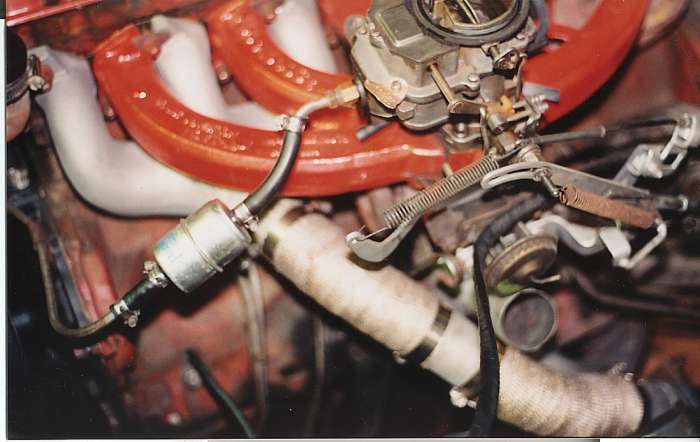

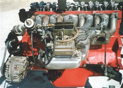

Here is a look at some of the original linkage used on the Hyper-Pak and for some of the development prototype units. One key thing to note is the use of "bellcranks" or "turnbuckles" (more on that in a moment). Note that the factory Hyper-Pak has the carb mounted "sideways". An aftermarket manifold has an enlarged carb mounting flange to allow carb mounting and linkage placement to support "sideways" or "front-to-back" carb mounting orientation. If you have an original Hyper-Pak unit, you will be limited to the sideways mounting and the carb linkage shown.
The
linkage shown here is for a cable activated "sideways" carb
mounting
system. One problem to overcome is finding a longer throttle cable. A
good source for a longer cable is a front wheel drive "sideways"
engine Mopar. There are many others to choose from at the yards. The
one I have is about 3 feet long (longer is good). I had to make up a
number of special linkage pieces and brackets so be forewarned,
machining and / or welding is required.

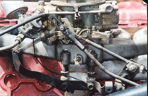

The
first step is to get the throttle linkage in place. You must decide
on your carb orientation and get it mounted. Make up a bracket as
shown, using a factory "screw-down"
cable holder, welded onto a piece of band iron. Next make a
return spring bracket. There are a couple of bosses available for
mounting this easy to build piece. If you are running a manual
transmission, you are done! That's right, let's go for a drive! If
you have an automatic trans needing throttle pressure, we still have
lots of work to do.

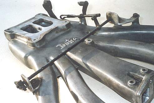

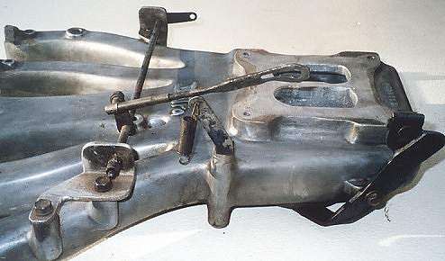

OK,
work from the middle out. We need to make a cross-shaft and two
support brackets. I actually used the main piece of the factory 1 bbl
shaft (14-11-1) linkage for this. It has a lever (14-11-28) already
installed on one end. Make two end support
brackets from angle aluminum stock. I had to move the second
lever forward on the shaft. You can have it clamp with a bolt or weld
it into place. (Don't weld it solid until you get everything made up
and correctly positioned.)
You
can use many of the early "rod type" linkage pieces.
Rod
14-11-9 was moved to the rear lever and dropped down to a "pivot pin"
welded to the lower bellhousing support bracket. This pin supports
bellcrank (14-14-1) or you can mount the entire bellcrank / plate
assy (14-14-4) low on the firewall to act as the pivot point. The
last piece of linkage is rod 14-11-9 (the lower two piece one with
the same number?!?) I had to lengthen these rods and did it in a way
that kept their length adjusters intact. Make all your linkage
pieces with means of adjustment, some have screw threads, others
have "slides" . You will need adjustment to fine tune the system.
At one end we have the tranny throttle pressure lever. Note that
there are different lever lengths available to help tune your overall
linkage "travel". At the carb, there is an adjustable rod with a
short slot. Here again, this allows for some adjustment and throttle
movement without boosting the trans. pressure for those late, high
RPM neck snapping shifts.
Look
at the photos below for more ideas on how the pieces go together. If
you have some additional pics please forward them, especially
Super Six shots.
