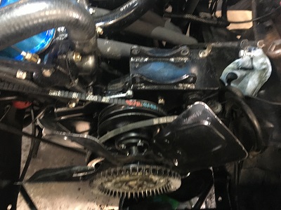

Here is a photo of the pulley / fan set up. Pulley diameter looks really close to the factory size. Sorry truck is not here to check for sure. A/C compressor sets on the plate. I believe that the whole set up was from Vintage air, so it is not something we threw together.
Could it be the new engine you ask? In what way?
Engine was in a truck and was run until an oil pump gear failed. Engine had the crank done and new rings, bearings...etc. That is it. Nothing that should cause a water pump failure.
The only thing I see on this set up is that the double pulley on the water pump has that 1" spacer behind it to move the pulley forward. That then moves the viscous fan out that same amount. That is the only thing I see that would not be an absolutely factory type setup.
