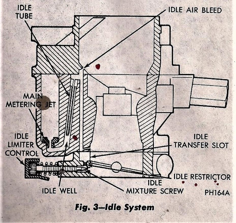

PostPosted: Mon Dec 07, 2020 2:32 pm
Posts: 1603
PostPosted: Mon Dec 07, 2020 2:34 pm
Posts: 1603
PostPosted: Mon Dec 07, 2020 2:35 pm
Posts: 1603
PostPosted: Mon Dec 07, 2020 2:42 pm
Posts: 1603
Idle restrictor started in 1977 it may be dirty or too small for today's fuel I would suggest cleaning it really good enlarging it or remove it altogether. At 5 turns out it's the Restriction that setting in your fuel mixture, not the mixture screw.
