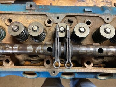

I made my own. Used a old rocker shaft and two rocker arms. Cut the shaft so a section could bolt to two shaft mounting holes. Welded two rocker arms together so the distance between them would stradle the retainer, on either side of the stem. Then welded a "lever" bar to the arms. I'll see if I can get a friend to post a picture for me

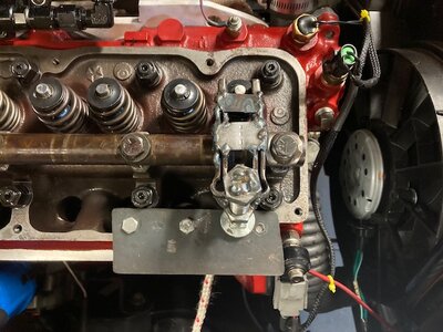

PostPosted: Wed Dec 08, 2021 11:46 am
Posts: 3832
Charlie's tool
after looking on line at the high priced rocker shaft supported valve spring compressor I started thinking on what I could build.
The thought of using a pair of modified rocker arms was one of the designs that crossed my mind. Hearing that Charlie S went that way was enough for me to say to myself,
"that must be a good way to go'.
Photo below is progress so far. The PRI show is in town starting tomorrow so it will probably be the weekend before I do much more on this.

That's just what I did. Welded a lever to both arms. I cut the shaft so only two mounting holes, and used the remainder of the shaft, as the lever.
PS: keep the rockers as far apart as possible, and still have good contact with the retainer. Makes it easier to get to the locks.

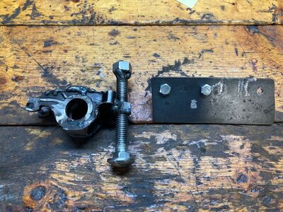

PostPosted: Thu Jan 06, 2022 7:19 pm
Posts: 3832
I had posted these photos in other threads, but not this original one,
so yes, the rocker arm shaft mounted spring compressor fabricated from a couple of welded together rocker arms worked great.
Having the jack bolt hold the compressive pressure on the spring giving two free hands to deal with the keepers was great.
It was very positive and secure in holding the valve spring at all times.
