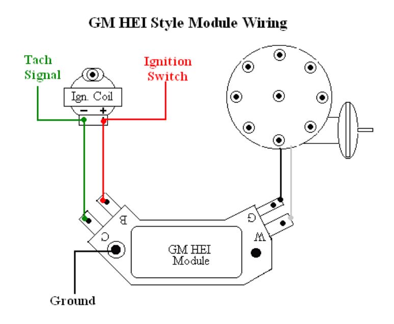

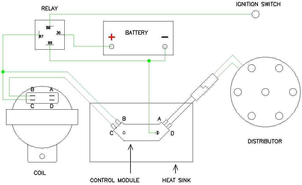

Attached are two of the most basic HEI diagrams. One with a relay, one without.
Either way, the "Ignition Switch" signal is the "Start/Run" from the OE vehicle wiring.
