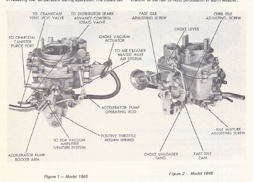

Vacuum advance is run straight to the base of the carb per the Holley 1945 manual.
Base of carburetor vacuum tap would see intake manifold vacuum. Advance needs to be plugged into ported vacuum tap located above throttle plates so that it only sees vacuum off idle when throttle is open at steady speed, and sees drop off of vacuum when accelerating.

So, if that is the case, which port should I be using and what do I do with the lines connected to the other ports?
The one labelled "To distributor spark advance control", which is probably where you have it hooked up. It is at the base of the carburetor, as was the correct port on this carb's predecessor (the 1920). The physical location of the vacuum nipple doesn't mean anything, so don't get sidetracked or confused that way.
See to it they're routed correctly.

I have everything connected as shown. My OSAC was gone, and all but the charcoal canister, emissions controls were stripped when I bought her. I've connected that OSAC line, bottom of the carb, to the vacuum advance on the distributor. Thanks!
