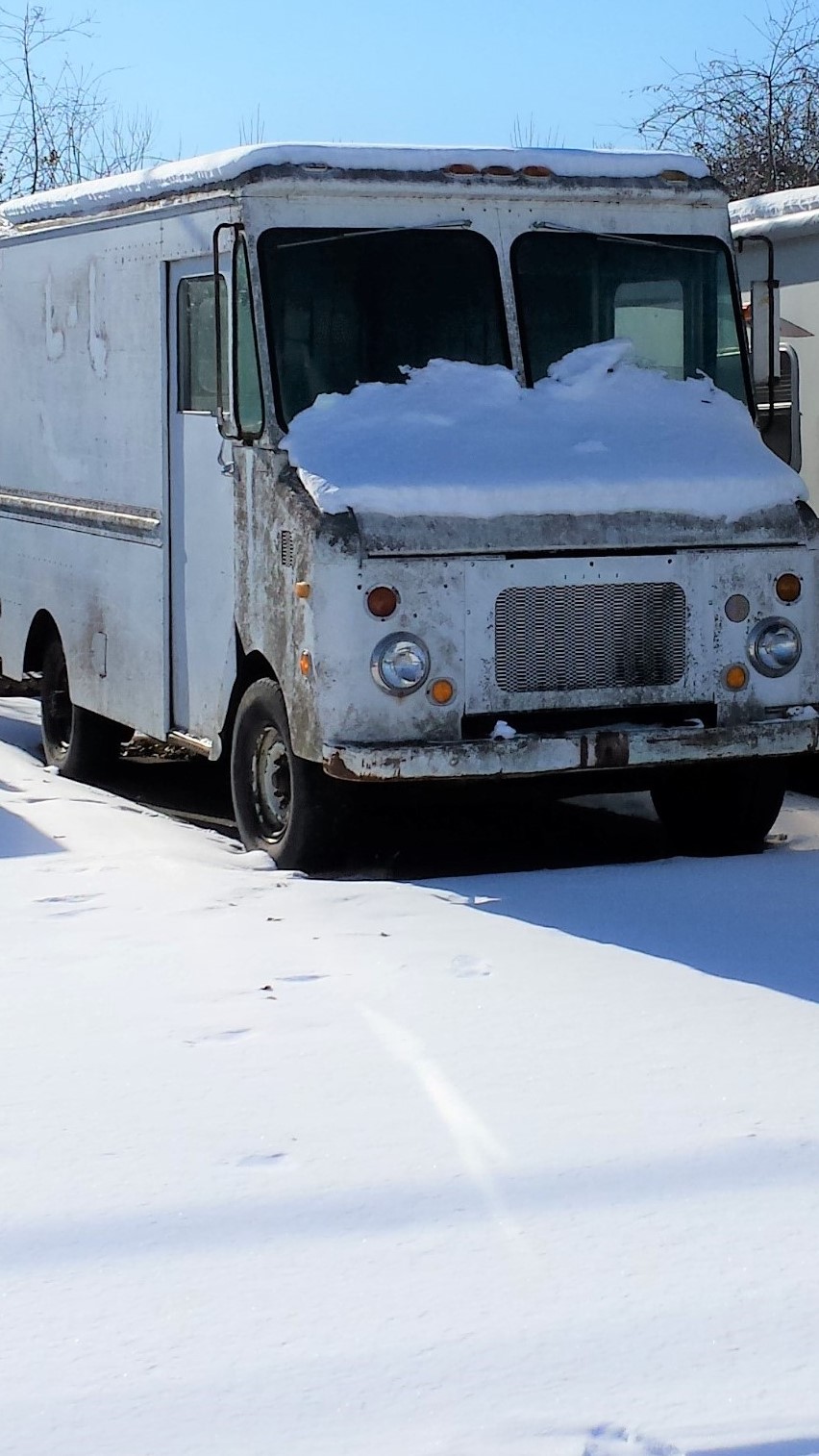

Here are a couple of pics of it.....
File comment: last winter...

Posts: 10271
Cool. That would sure make an awesome track day vehicle. With plenty of room for napping and spare tires etc.
