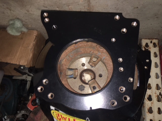

Here's the photo. It looks like the bell runs all the way out to the block-to-bell bolt holes, which is good.
It sure doesn't look like a very deep bell, though.
If you look at the starter mount, it's a pretty simple piece of flat plate. I'm wondering if I could cut it off and/or modify it with the proper spacing away from the crank centerline. That's all that really matters to the starter.

Early A body V8s had 122-tooth flywheels and used a 9.5" clutch. The bigger bell will fit with some hammer work to the firewall pinch weld.

So I dug out a Schiefer flywheel that I bought on ebay a million years ago....it's a 130 tooth flywheel...and put it on a 170. The good news is it fits.....there's about .360" clearance between the bolt shank and the teeth. That's not much but it's plenty 'if' you design the bellhousing to suit. I'm optimistic the QT will fit, but that remains to be seen.

The QT bell arrived today....
Here it is bolted to the 170. No interference issue with the flywheel, not even close. It also holds an 11" clutch. I didn't look at a throwout bearing but since the bell is the standard Mopar depth I don't foresee any fit issues.
The starter is 'off' as we knew it would be, but since the bell is made of steel that easily remedied with a Sawzall and welder....
I'm not sure if I gonna modify the bell right now, since I have other projects going on, but I also don't intend to return the bellhousing since it seems to open a lot of doors.

Why is the starter "off"?
Is it because you are using a larger than usual flywheel here with this bell housing?
PostPosted: Wed Jul 03, 2019 3:34 pm
Yes. The starter position is meant to fit up to a 122 tooth flywheel. So the larger diameter of the 130 tooth flywheel extends into the starter area.
As as aside, this is a nicely made part...heavy, but well made. I kinda thought the newer bells would be not as good as the old Lakewood stuff but this one is actually nicer.
