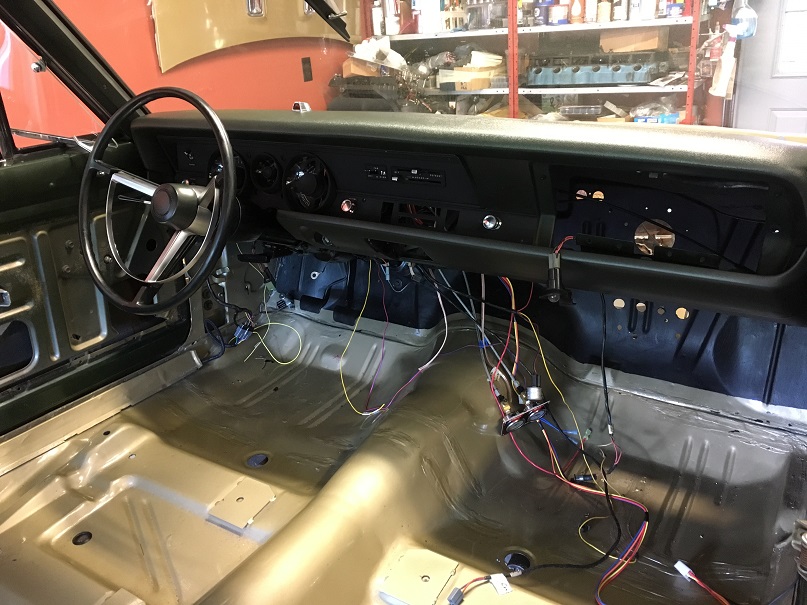

Most of the month of May was dedicated to the Safety Patrol and the Indy 500 support, then I needed some time to get the outside lawn and bush stuff done for spring.
With that done, on Sunday and today I got a couple of good garage days in.
The dash is installed, some of the new under dash wiring is ran, but not all hooked up, the cabin wiring is about done.
The next items are: the under hood wiring, that includes a centralized relay box and to get the valve spring pressure right I need to have the spring seats trimmed, so its
one more visit to the machine shop. Then I can finish assembling the engine and get WV over for an engine install party.
