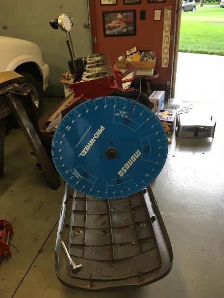

Degreed the cam today. The ICL is set on 100
I don't do this often enough to remember all the ins and outs,,
I called Charlie S and he had me straightened out in a matter of minutes,
but then we had to talk on the phone for another half an hour,
but that's what having this hobby is all about,, its the folks you meet along the way :D

Wow, I like that big degree wheel. I think I need to replace the smaller one I have been using with one of those. Looks much easier to mount and read.
PostPosted: Mon Jun 24, 2019 1:25 pm
Posts: 3857
big degree wheel
I also have an eleven inch Summit degree wheel, that I put away somewhere in the garage.
Looked for it several times and was not able to find it. Knowing that all I had to do to find
the lost degree wheel was to buy another, and since I already had one, why buy another one identical
to first one. So I bought this 18 inch Moroso wheel. And I do like it, the way the wheel in marked it is very
easy to time the cam using the ICL method, and you can still get the individual cam event timing.
And of course, because I bought a second the degree wheel, I found the first one,
so I have two.

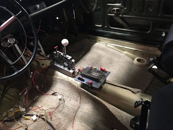

progress on the 68 Barracuda, wiring has been the recent focus, I used a mid 90's Caravan power module when upgrading the circuits on the 83 D150, as I was already familiar with that box I also installed one on the 68 Barracuda, The OE fuse panel remains, however for circuits like headlights and the radio, the OE wiring serves as the trigger for relays in the power module. The power module directs the current flow for the two items mentioned as well as the added electrical components like the MSD ignition, MS3 Pro, electric radiator fans, electric fuel pump and the line locks.
Recent good progress includes the re installation of a delay box. The delay box does not run a trans brake but does control front and rear line locks and also through a relay in the power module integrates into the MS3 Pro to pull ignition timing and or cut cylinder ignition or fuel while the delay timing is engaged.
Photos show the power module and the delay box
Video shows the delay box panel in operation, all the wiring is not fully installed, I like to test prior to the final wrap.
There is a safety cover over the power switch toggle with a power on LED
The single momentary switch operates the front line locks with a square red LED indicator
The large button operates the delay box that controls the front and rear line locks, the rear line lock has a yellow square LED indicator
I have the delay set to three seconds.
https://www.youtube.com/watch?v=eORSDZ3jezY

Posts: 9347
What is the rear one for?
PostPosted: Wed Dec 11, 2019 5:42 am
Posts: 3857
What is the rear
The footbrake applies the brakes at both ends. What I did was automate the controls for a footbrake launch.
