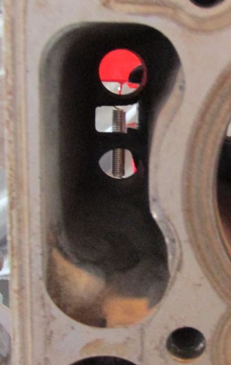

Some images,
Alum block #6 with old correct gasket, Alum block w/steel shim, Alum block.

Yes I think we have the answer. You can use later heads on alum blocks with the right gasket. You can use a 75 up head on any slant (ex hydraulic) so it stands to reason it could also be used on a aluminum slant.

The 75-80 (or 79?) solid lifter head will fit with no trouble. The 81-up hydro head has scalloped out water jacket holes and may not have sufficient surface to seal to the open deck Al block.
