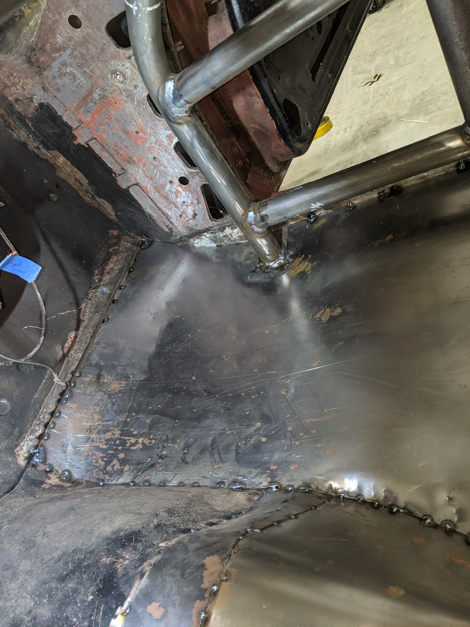

Adam has started on the floor... Progress!

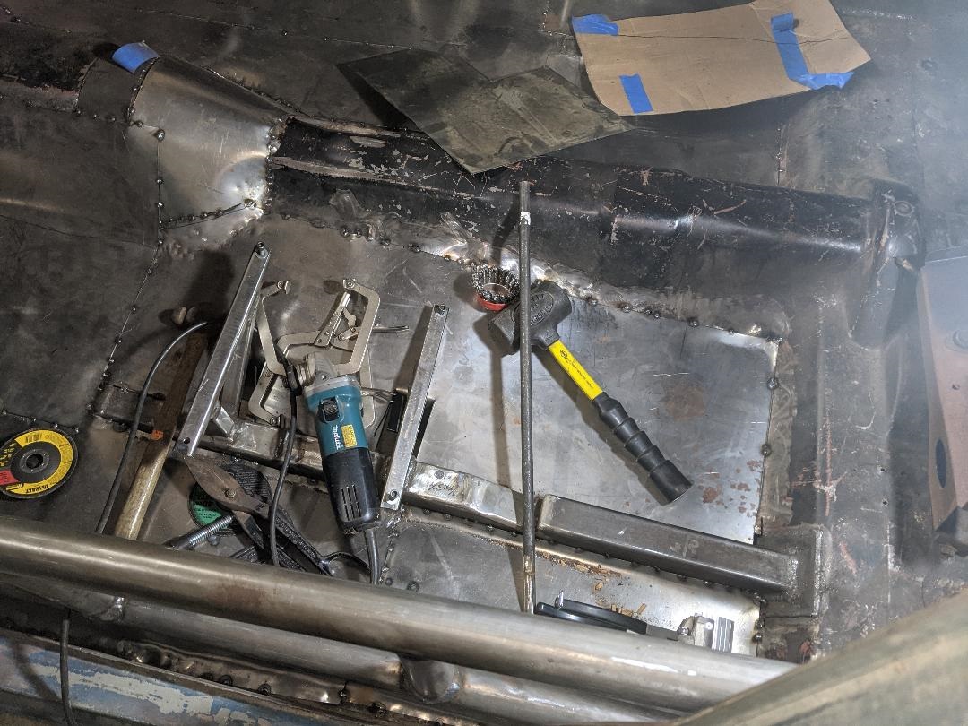

Adam has made more progress on the driver floorboard.
I ordered the fuel cell, longer wheel studs and brake proportioning valve.
Joe and I are brewing up some engine ideas...
