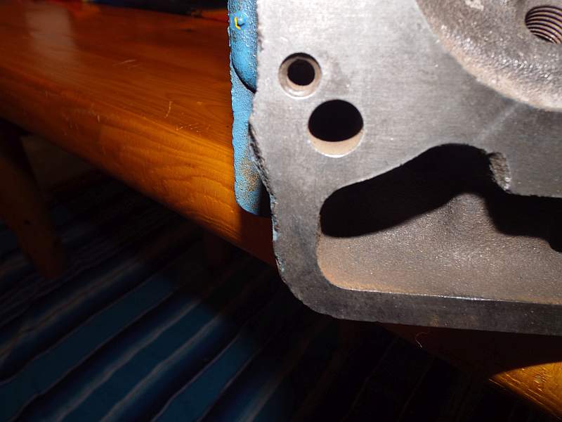

Here, I show the locator hole for the dowel pin. The as cast factory chamfer around the hole. No milling. Not even evidence of a broach or rock cut.

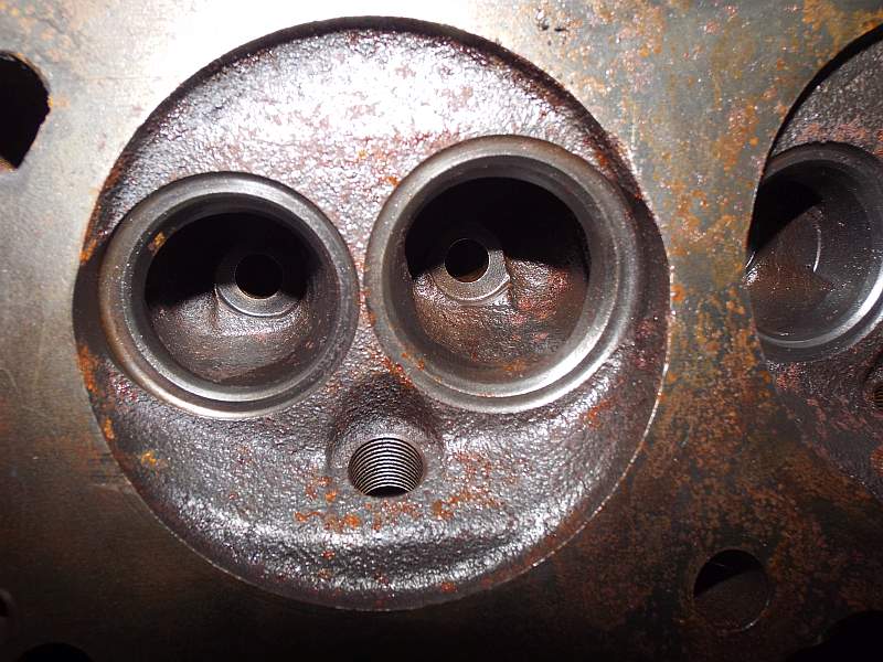

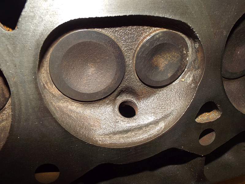

Here is a comparison between the chamber "smiles". I thought at first the closed chamber smile was a little smaller, but looking closer, I believe it's the same. I'll let yall decide.

That's it for now. I think beyond a shadow of a doubt, the head is as cast from the factory. I'll have some chamber numbers tomorrow when it's a little warmer out.
