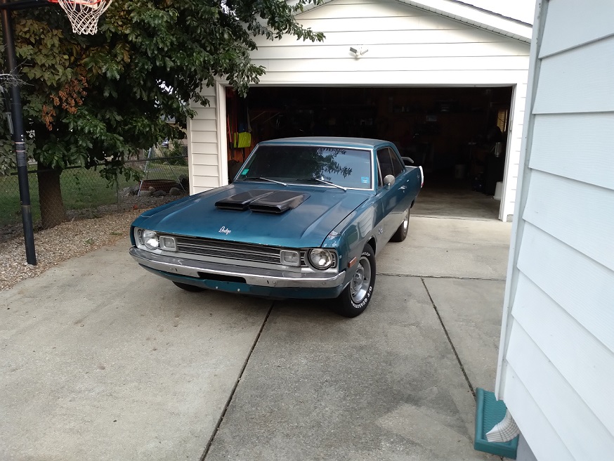

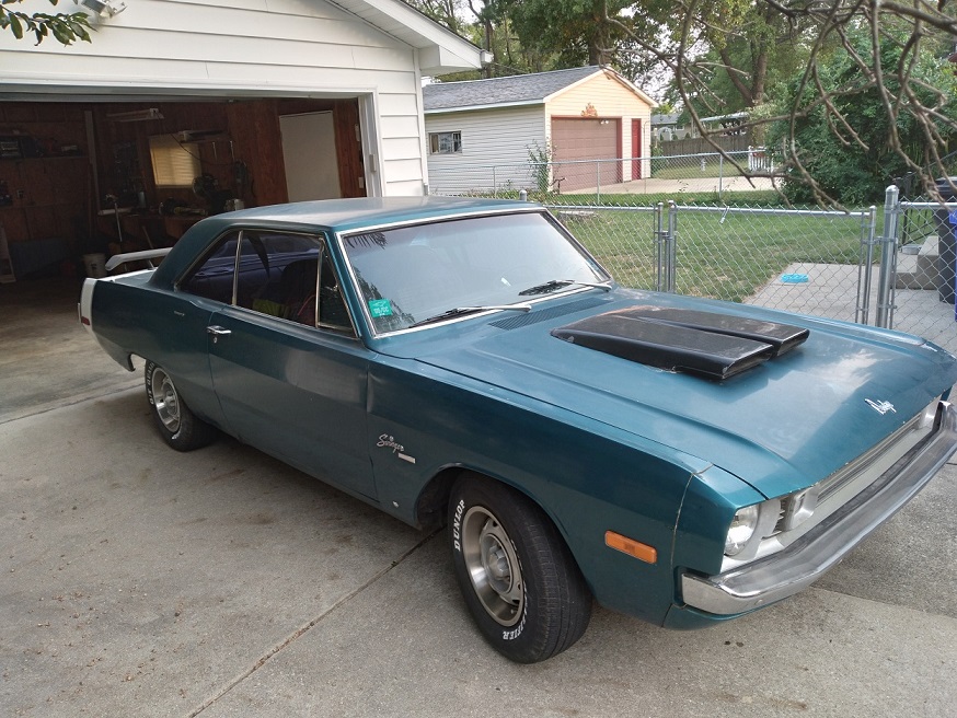

Hi all,
My name is Chuckster. My 14 year old grandson, Logan, recently bought a '72 Dart Swinger 2 door as a project him and I will work on so he can drive it when he turns 16. We live in central Illinois. We (grandson, my daughter, and I) drove just over 3 hours north to Marengo, IL. to look at it, bought it, and drove it home! We passed the Chrysler plant in Belvidere to get there. Only issue we had was a possibly factory spring clamp on the bypass hose rusted in two, causing an anti-freeze containment issue. Once we replaced the clamp (by bypassing the heater core to borrow a clamp) and adding water we made it home without any issues. It's a factory A/C car (but all under-hood items are missing), power steering, manual disc brakes, and someone recently converted it to Electronic Ignition. It does have some rust, but it was undercoated when new, so it doesn't appear to be too bad for a car that has lived in Illinois it's whole life!
We are currently working on the mechanicals to keep it in running condition. So far we have changed both motor mounts (pass side was in 3 pieces, had a little extra lean to it...lol), removed the radiator, thermostat, and water pump to replace with new. Tomorrow we will tackle replacing the timing chain and gears (doesn't look like its ever been apart), and going to try adjusting the power steering box to try and eliminate the large amount of play in the wheel.
I have been a Mopar man most of my adult life, so I know quite a bit about them, but from time to time I will probably ask questions of things I'm not sure of.

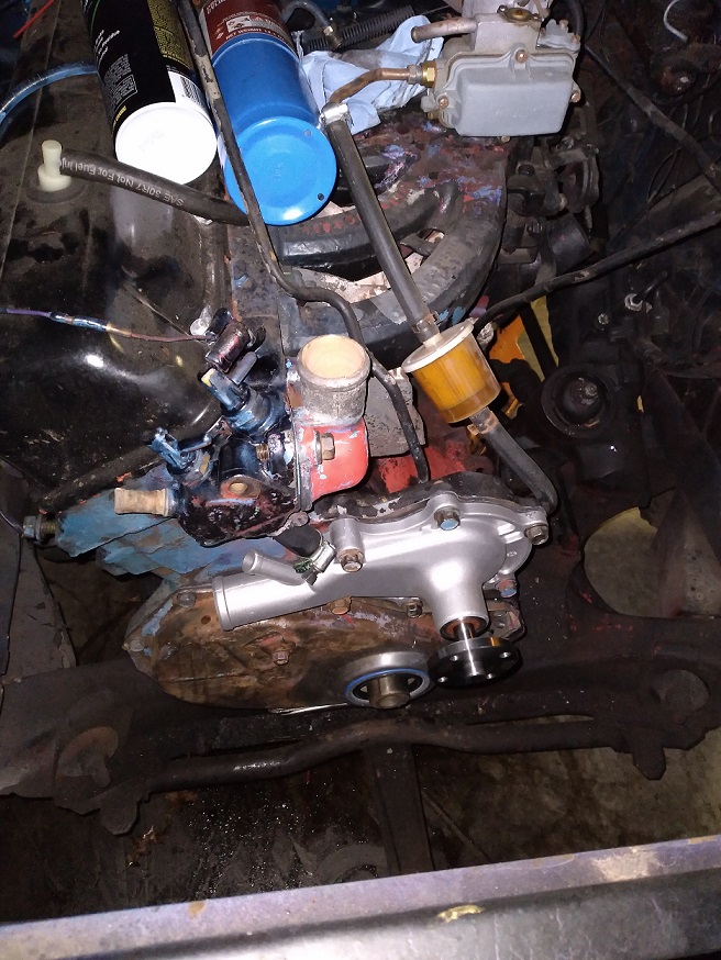

The last week, and today, we got all of the old, probably factory, gasket material from around the timing cover and water pump. That was a lot of work. Wound up using my right-angle drill with a cup brush, and it was slow going. Last Thursday we tried installing the timing cover, but couldn't get the two dowel pins through the holes in the cover. Only way I could figure out how to do it was by dropping the oil pan slightly. Friday my grandson got underneath and loosened the pan bolts about 2 turns. Had to raise the engine a little and remove the driver's side motor mount bracket to access a few of the bolts. Today we were able to drop the front of the pan just enough to seat the timing cover. Then we proceeded to install the new water pump and bypass hose (with worm-style clamps), and the new 180 degree thermostat. Hopefully tomorrow we can repaint the front of the engine Chrysler blue, along with some other areas we can get clean enough.

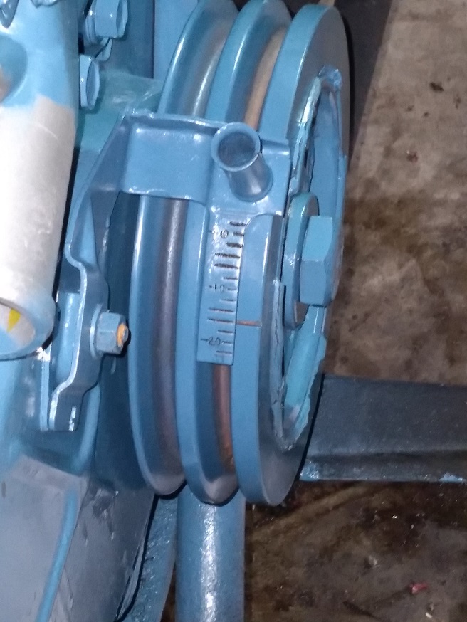

Made some good progress today, I cleaned and painted the left motor mount bracket while Logan was in school. When he got home we did a lot of cleaning and painting, installed the left motor mount bracket, installed a repair sleeve (groove in damper where seal rides) and installed the harmonic damper. A few days ago I detailed the timing mark bracket to easier see the marks.
Tomorrow the carb comes off to replace the leaky carb to intake gasket. Will probably do some cleaning of the intake while the carb is off, and paint it blue.
