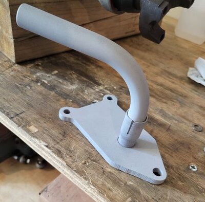

don't know if they are still available, but just fyi the hooker headers have a small tube coming of one of the runners that connects to a plate that attaches to the intake for heat.

Yes they did, it looks like this:
Is there actual exhaust flowing through that? I can't imagine how that actually warms up the intake if it is just a dead end tube.. Can someone explain how the Hooker intake heat system works, for those of us who have never seen such a thing?
 Post subject: Re: Dutra Duals Question
PostPosted: Thu May 11, 2023 12:12 pm
Posts: 2750
On the Hookers I had on my Barracuda it was just a companion flange like the one shown but on one tube.
I don't remember which but it was close to the center.
There was no hole in the header or in this plate either.
I guess the theory was as the air heated due to exhaust gasses it would rise and warm the underside of the intake.
I never used it as I had it in a race (street) engine and never ran it in cold weather.
And the Hyper Pak I had didn't have a provision for it anyway.
PostPosted: Thu May 11, 2023 4:33 pm
Posts: 9518
If you are worried about having heat under the carb, then you know your answer. Modified stock manifiold. But as was mentioned in your other thread you are not in a really "cold" area. Others in much worse climates run all year without manifold heat and headers. Myself included.

Posts: 2750
Interesting story,
one of the Chrysler engineers drove one of the Hyper Pak Valiants back from Daytona.
Somewhere up north the car was driving poorly.
He pulled over to find the bottom of the intake packed in a block of ice splashed up from the road.
I think they chipped it off and waited for the exhaust to melt it a little before continuing on their way.
I need to go find that source again.
CORRECTION: There is a hole in the bottom manifold plate! But not the header.
