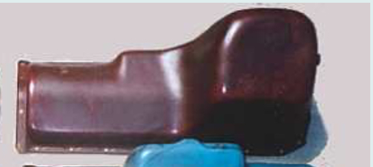

I am going to be running a 904. Believe this is the pan that came off my engine.
That is the 1971-1987 D series truck and B series van slant six oil pan. It absolutely will not work on a 64-66 A body car.
The transmission issue is the torque converter hub diameter change that happened in 1968. If you are using a 1968-up 904, you are fine. You will have problems if you try mating the 70s era engine to a pre 1968 904 transmission, though.
