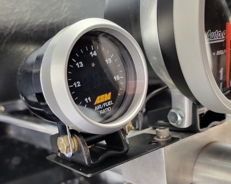

Been a while since I posted.
A couple of life events have slowed my progress.
Here is a short run down of Colt progress.
The clutch pedal has been welded and re-drilled for the smaller rod end bearing to the master cylinder.
The clutch pedal now feels good to me, no sticking.
The clutch tamer has gone back in.
There was a fellow on FABO who used one years ago and he gave some great advice and pictures of his install.
Heat shield on the bottom of the Webers.
One turn tighter on passenger Coil Over, tires adjusted right and left to control launch out of the hole.
It wants to go right coming off the line.
I plan to launch at 4500. We shall see.
New set up on the Weber Jets to what I have been advised to tweak.
AFR Gauge has been installed.
It won't read AFR at Idle, experts say not enough tube length.
I purchased a German made Synchrometer to balance the Carbs.
I was going to T&T tomorrow but I don't feel great, so maybe next week.
I have my 170 back from the machine shop.
Fitting the 198 crank and grinding big metal.
Still deciding on which pistons and compression ratio.
This engine will need new headers to fit in the Colt, Low Block.
Looking forward to 21xx lbs. car.
Another 225 on a stand that will get a set of 3.500 pistons.
That engine will be dry sump and crank trigger.
Total Seal Rings.
Locally built head.
I want this 225 to replace the Colt V3 that is in the car now.
I don't want to be down more than it has to be.
Droll head is at the machine shop getting new rocker shaft supports.
This head will go back on V3 when it is pressure tested and new valves.
Thats about it.
