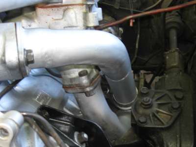

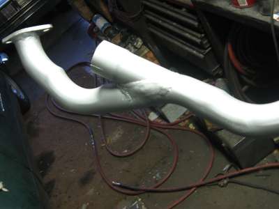

We did manage to get the exhaust system reworked over the weekend.
I am getting pretty good at retro-fitting a single exhaust system into a D. Duals with a Y-pipe... the Dacuda already had a new 2 1/4 head pipe, so we took a few measurements and added-on a piece of pipe to allow a "slip-in" connection point.

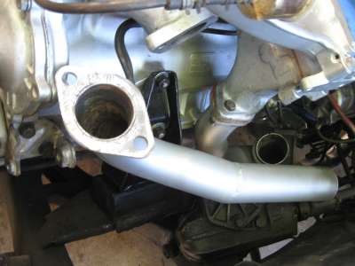

Then it was a matter of making a short section of pipe to connect the front Dutra exhaust manifold to the "y" point. We worked inward from both ends, a flange on one end, a short length of pipe sticking out of the slip-in socket... and met in the middle. One final weld and we had the remove-able front piece.
I have learned to keep the front section of pipe close to the rear manifold, almost touching... that gives you the shortest path and the most room & best clearance to the steering box.

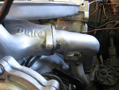

Here is a different angle, you can also see the bottom of the clamp used at the slip connection. We also added a exhaust "dump-out" cap under the car, just past the trans cross member.

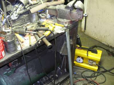

The system turned out nice but it took way too much time and I trashed my work bench in the process... need to do some tool "put-a-way" work and finish this install.

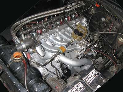

We broke-out of our "funk", focused on getting a few more key things hooked-up, poured in some oil, water and gas, turned the key and Buster jumped to life. :D
The first 10 to 15 seconds seemed like 10 years... with no oil pressure, then the gauge jumped-up to mid-point and we have a running engine!
I feel much better... it's been 2 weeks since we started this engine swap and between work, life and a zillion little "details", I was getting to the point of asking myself: "will this engine ever run"?
Answer: YES!
We are not done yet...
There are a couple of "hard to get to" bell housing bolts that need to be installed, the kick-down linkage needs re-engineering, dipstick and tube have to go in, adjust the timing, adjust the valves, valve cover, air cleaner.... basically all that "finish it" stuff.
Here is a photo:
