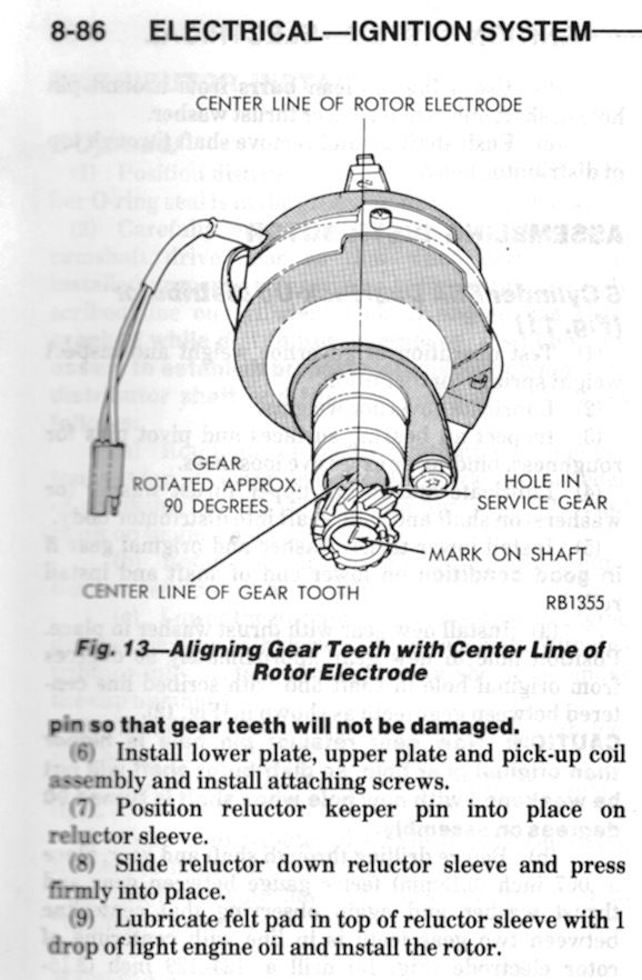

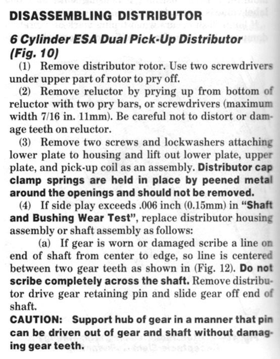

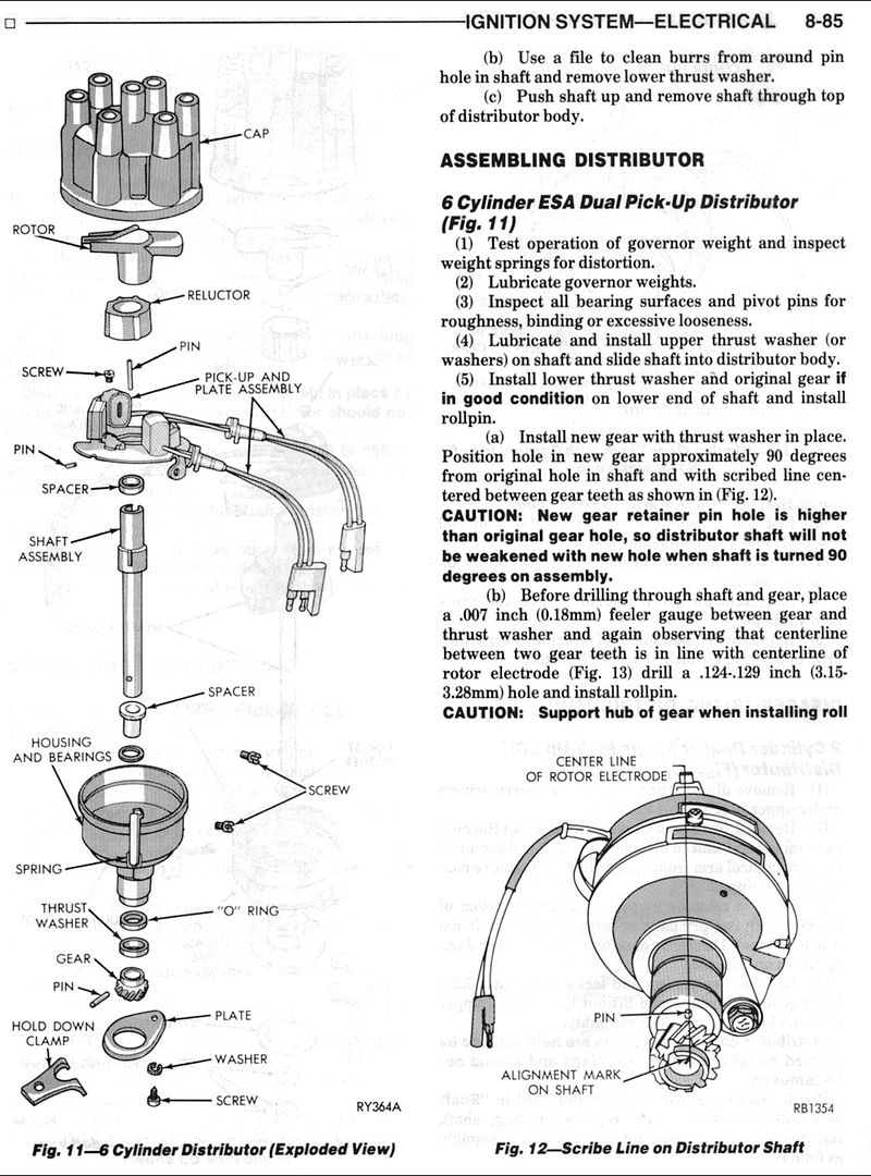

Here are the scans:
I would clean all the bits and pieces in your favorite solvent and check the shaft for excessive wear and play.
Your distributor will have a vacuum advance pod not shown in the above diagrams. It unscrews from the body of the distributor and has a little arm with a stud that fits into a hole on the plate supporting the points. It is fairly obvious how to remove it once you are in there. Be sure to check that the vacuum advance pod still holds a vacuum. If it doesn't, you will need to replace it.
I would put the springs and weights and governor in a bag and save them for your new distributor. When your new distributor arrives, you can disassemble it, clean it, and reassemble it with the springs and weights and vacuum advance can from your original distributor.
Go slow, and you should be fine. Good luck!
