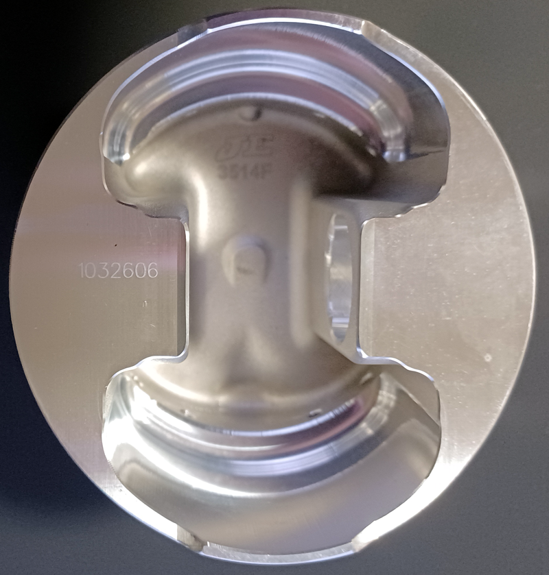

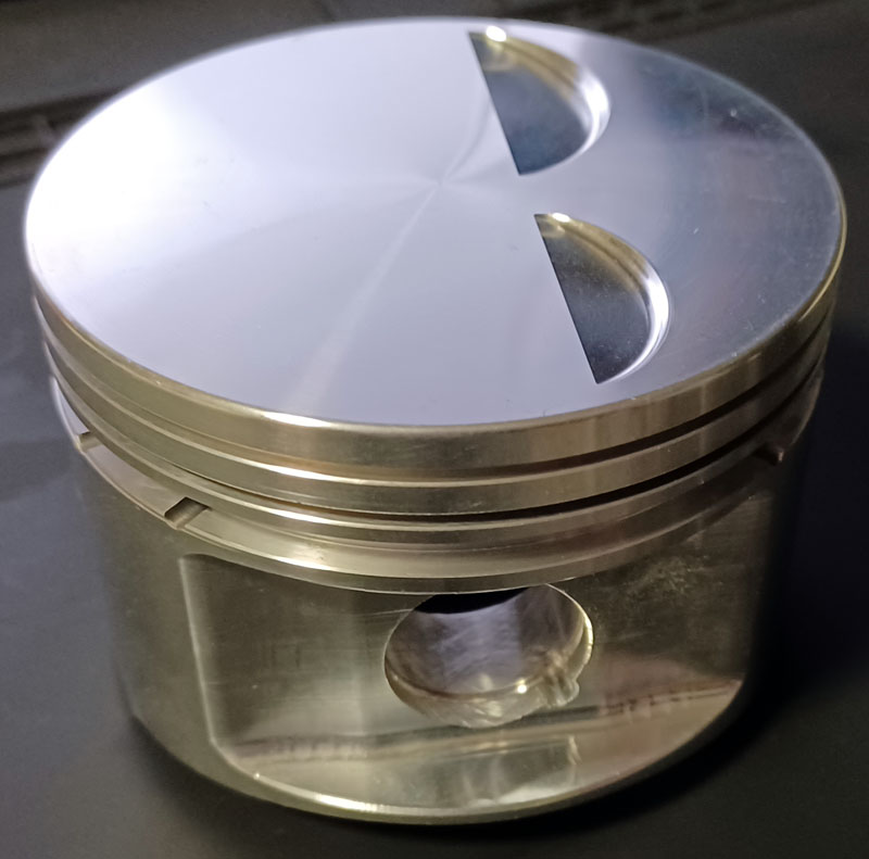

Been years...maybe 5yrs since I've posted. Still try to keep up once in awhile. I wish this piston buy had happened back in 2015 or so, although I've always kinda done things my own way. After reading through this thread, I noticed quite a few people asking about floating or pressed pins and oiling for such. I don't want to hijack the thread, but I do have a few pictures that members might find of interest.

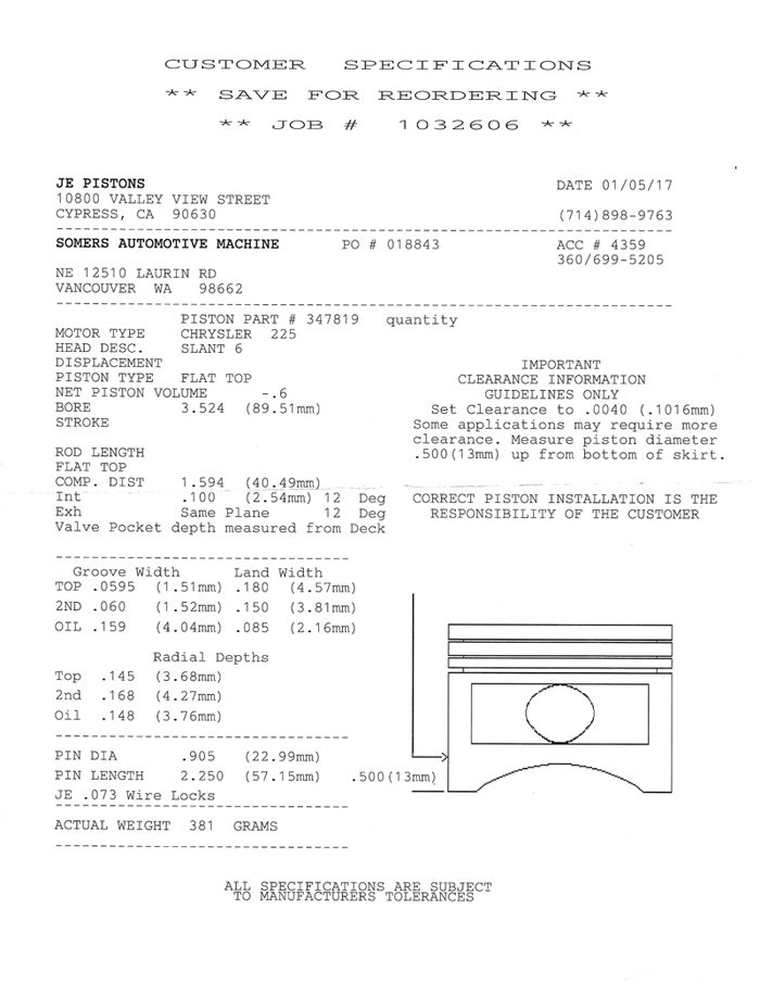

First, I'm building a 243.87" motor using a stock crank, K1 7" rods, and JE custom pistons purchased in late 2016. They were at that time $740 with rings.They are setup for "0" deck with a minimal cut on my block, machine work completed in early 2017 then life went sideways again. I'll post about that on a thread of my own.
These pictures are representative of what you might get if you ordered a similar piston and the the JE spec sheet as well. Piston weight 381 grams.
Piston top side...
From bottom...

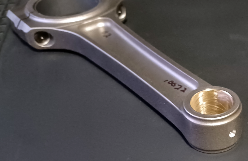

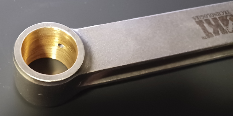

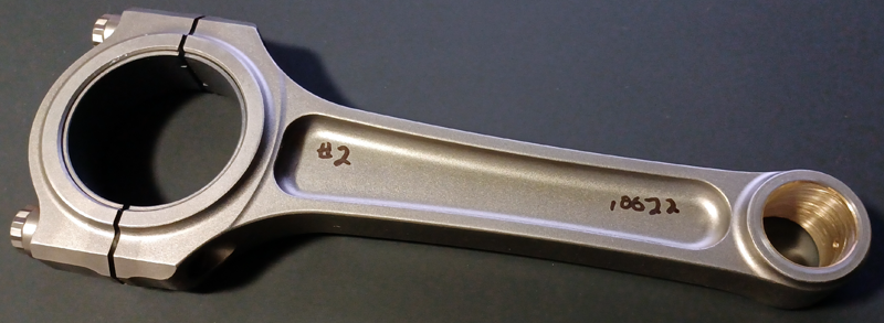

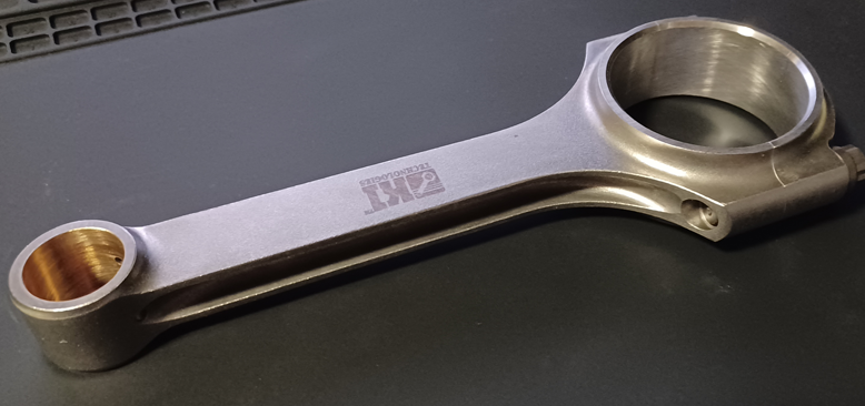

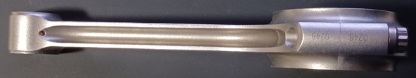

Anyway...I have pictures to show my K1 rods and how they handle the pin oiling, and the Crower rods for our Pontiac and how they handle the oiling.
First, the Crower 7.1" rod, pin is oiled from the top...
K1 7.005 Rods oiled from two holes from opposite sides from the bottom of the pin bore...
That's all, just there for visual information of how two different companies approach things...there might be good reasons because of the different rod designs, but I leave that to the companies making them to decide.

It's by design, H-beam rods are drill through the bottom below the wrist pin while I-beam rods are drilled through the top. All manufacturers do this depending on the style of rod used. Carrillo, Crower, Oliver, etc....
