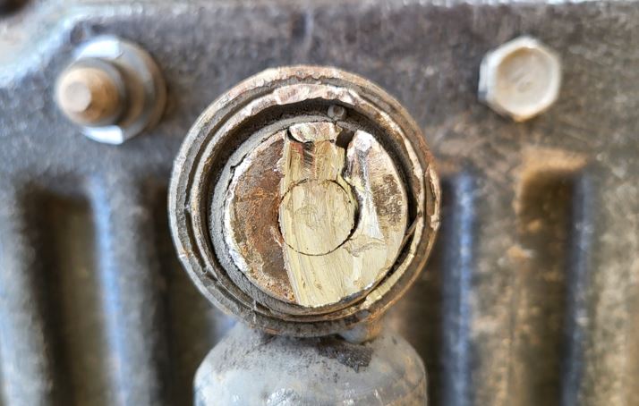

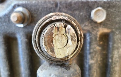

Friday my son called me and his honda was broken.
We spent all day Saturday replacing the O2 sensor and changing the rear struts.
The O2 sensor looked to be damaged by the cat coming apart.
One of the rear struts had fused the 17 MM bolt to the lower bushing and would not move.
3 hours of using a small cutoff wheel on the nut, bot head and finally the bushing.
I ended prying the shear bracket open and driving what was left out with a large hammer.
Good thing I had an empty bay because the Colt was in the trailer ready to go.
So that was how I spent my "Race" day.
