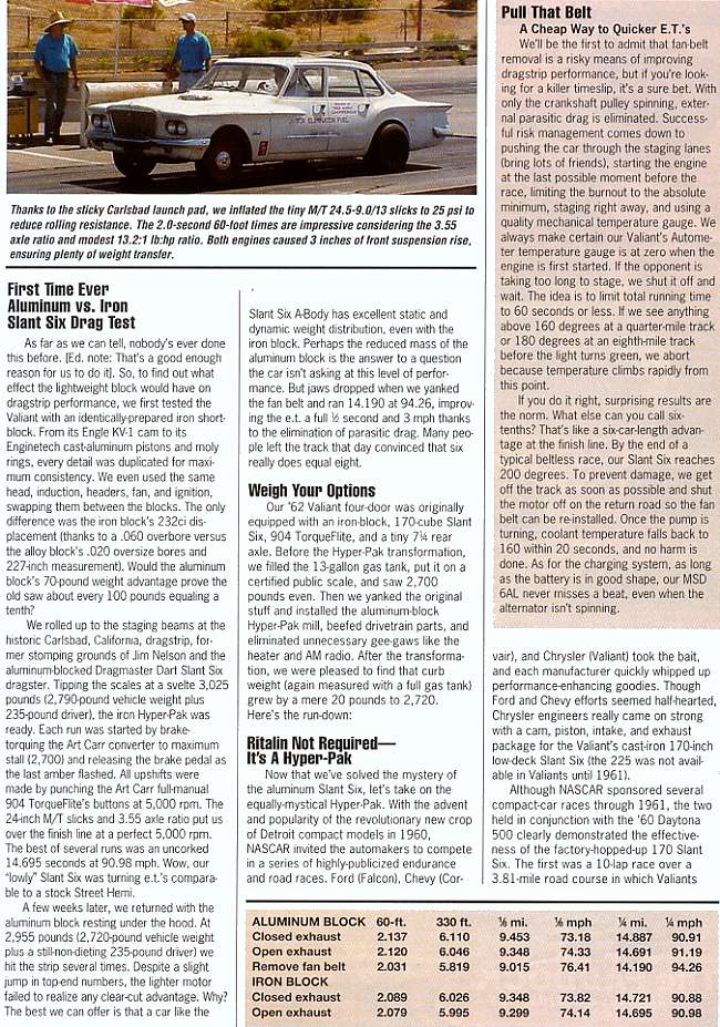

Man I love this stuff!
I'm sure you've all seen it, but from the very web site you are on comes a reprint of a magazine article which claims (I tend to believe it) 6 10ths in the 1/4 from removing the belts. Call me crazy, but it makes me think there's gold in them thar belts!
http://www.slantsix.org/articles/hrm-sl ... 03-pg2.jpg
I understand about no free rides. I figure 3 batteries weigh 100lbs, can be mounted anywhere on the car, and would probably take 10 hours to recharge (using 3 chargers). But I also am guessing that three batteries could run all the accessory loads for maybe 8-10 hours, depending on a whole lot of stuff. And I understand that you'd have to whomp up a step up transformer/power conditioner for proper ignition voltage.
If you take a close look at how you drive your slant, you'll see some places to take advantage of this plug-in idea. If you are delivering pizzas 6 days a week in it, then no this might not be the ticket. If you are just cruising or using it for racing/smuggling drugs, then maybe a hybrid approach could work. We will see.
If anybody has access to a chassis dyno, make a run with the belt and one without. That will end this discussion quickly.
And how much time do we lose in the 1/4 by hauling a couple hundred pounds of batteries in the car...?

On my 66 Valiant, I lost the fan/alt belt doing a burnout. On that run, I picked up just about 2 tenths and 2 mph. The actual gain is dependent on the state of charge in the battery. I have a throttle switch in my Cuda that opens the alternater field circuit during WOT. This car has a 110 amp Denso alternator. If the battery is about 1/2 discharged, it will change the idle rpm about 200 rpm, between closed and open field circuit.
None of this will help economy. It is a case of power based on time (amp hours). It will take the same amount of fuel to charge 10 amps for 10 minutes, as charging 5 amps for 20 minutes.
How about hooking up a large alternator to the driveshaft. During normal driving, the field is open (no charging), when at closed throttle, the field closes (now charging), this would be similar to regenerative braking. Under conditions, where there is not enough closed throttle to keep the battery charged, the field would be energized, when the battery charge dropped to a certain level.

What does a dragstrip calculator show as the power difference needed for 2 tenths at your car's weight and speed?

If you all dig back through this thread, you'll find the link to the BMW article, which purports that their "smart" alternator returned either a 2% or 4% improvement in economy. I'm too lazy to dig out the actual figure.
