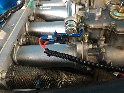

when it rotates it deactivates the sense wire to my alternator
That is a VERY cool idea. Mind if I steal it?

How many amps are you running thru that little switch?

I don't know Ed. Maybe I should? It's not a Mopar alternator. It is like the small one wire alternators except it needs that "sense" wire to charge. The One wire alternators kill your battery after about 2 weeks of setting and I got tired of that. Lou knows what I have and may be able to shed some light on this alternator. I am electrically challenged. :D
Matt help yourself! I copy things from people all the time. I copied the alternator from Lou!! :lol:

That is just a wire to run the regulator. I would guess substantially less than an amp, but have never measured it.
My guess is you're looking at maybe a few hundredths in the 1/4 when you shut the field off, but I guess every little bit counts.

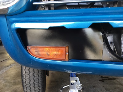

I'm looking for 5 hundredths! :D :D Also have my block off plates made for both sides of the valance. That may help another hundredth!! :D Pictures to follow!

Here is the final product on the micro switch.

I made aluminum panels for the valance and got them in place. I made them so the turn signal lens holds it in place with one other screw into the radiator support. This is not weatherproof of course but my car hasn't seen too much rain on the drag strip! :D :D Fits nice and tight and looks like it belongs. Hardly notice them. I will probably put something under the valance over the winter to try and keep some more turbulence out from under the car.
