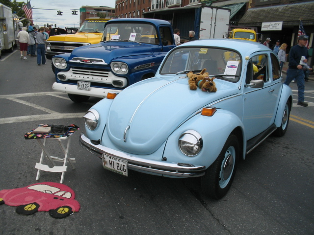

Here's another show winner.
Being the owner of a show winner does not make you an authority of any kind. I am not riding coattails here; I find this angle inane to the point of being offensive. Shows are breeding grounds for all kinds of disinformation. If I want to learn something useful about my car Im not going to do it by pulling up a lawnchair and sitting in a circle of stereotypical hotrodders trying to grandstand each other with half-truths and fishing stories. I bury my nose in a book, I suggest you do the same.
I've been calling it as i see it for my entire life and that's not about to change. Take it or leave it.

From the looks of your car I suggest you read on.
Nice bug though.
