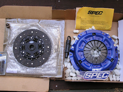

 Post subject: Results-- Very positive!
PostPosted: Sat May 31, 2008 10:28 am
Joined: Tue May 06, 2003 5:53 am
Posts: 750
Location: Crestline, CA
Hi all,
So, I have been working with Matt at SPEC clutches over the last couple of months. I needed a mustang disk ( or a custom disk with a T5 hub) and a pressure plate that would fit our flywheel. I got a 300 ft/lbs custom kit from them, and in initial fit testing, the clutch is working very well.
The clutch disk has kevlar friction surfaces
The pressure plate is a modern diaphragm style, and will work with the standard T5/mustang diameter TO bearing
This is a 9" clutch, and weighs a lot less than the 10", but should have the same or better holding power.
Matt has talked to me about offering this whole thing as a single part number, either with the ford style clutch disk hub, or a mopar one. We decided to wait until we test it all out on my car. If this works, it should be easy to order your own.
I will keep updating this thread as more is learned. Thanks to Lou and Menko for helping out.

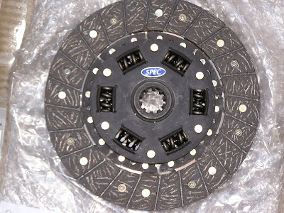

PostPosted: Tue Jun 10, 2008 10:47 am
Does anyone care that the friction material pictured does not appear to be Kevlar? Spec Clutch's Kevlar material is tan. The organic material is pictured in Greg's post.
