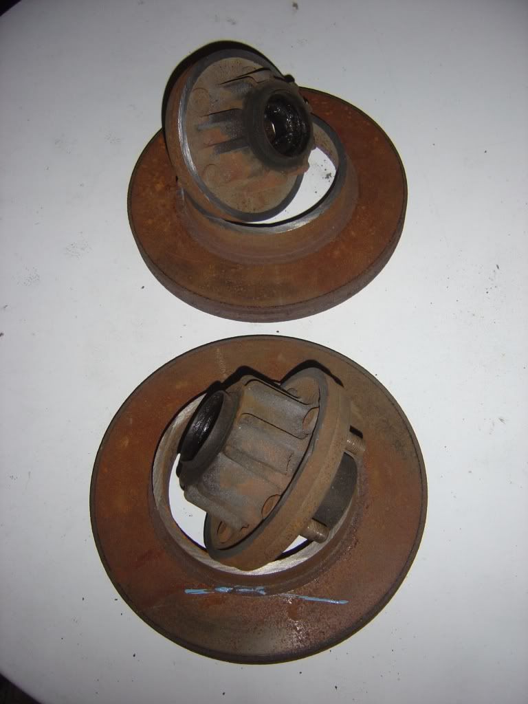

I was looking for B van hubs, not B body hubs. Those hubs use a smaller inner wheel bearing and wont fit over my disk brake spindles.
The inner wheel bearing on the van hub is even bigger, but the ID of the cone might fit over a disk brake spindle.
Either way, I have my disk brake rotors to cut down for the hubs.
Thanks for the offer, though. :)

I've cut down rotors before to make hubs. Well at least I did that trick once which was all I needed before I switched to just making custom hubs. The nice thing about cutting down rotors is that it is cheap, but then you're forced to live with a fixed location for the rotor. If you can't find the rotor you want then you have to build a custom hat and now things get complicated.
For me it was just a lot easier to start building custom hubs and then using off the shelf rotors. Kind of like when you build an engine it is easier to use custom pistons and shelf rods than to do it the other way.

True, but if you don't have access to the equipment, building your own custom hubs gets expensive, really fast.
Not willing to go to aluminum hubs from Wilwood, and don't know of anybody selling just steel hubs. I think that includes even you, Andy. :wink:

PostPosted: Wed Apr 22, 2009 11:09 pm
Joined: Mon Nov 28, 2005 10:35 pm
Posts: 665
Location: Spokane, Washington
Man, can't believe how long ago this was. I'm embarrassed. :oops:
(2) use rotors + 2.5 hrs of hard labor =
:D
'15 Chrysler 200S V6
'74 Duster 360, factory 4 speed car
PostPosted: Thu Apr 23, 2009 7:01 am
Hard labor? You're supposed to bribe a guy with a lathe. That's a 6-pack job at the most.
