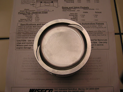

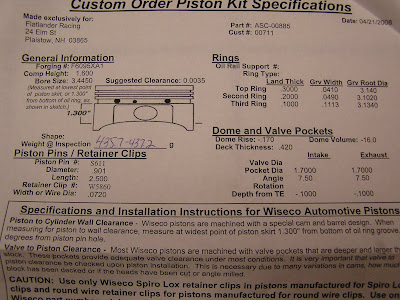

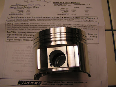

Yes pics of the pistons and rings ( close up of the rings) would be good.
ALso how far down from the top is the first ring land/groove on the piston?
WHat is the deck height of these pistons?
The CC thing may be because of the amount of room the piston has to allow for such things, in other words it may not be able to have any more CC's than what was given. As long as the compression is atleast down to 9 to 1, I would not make any changes to that. Carefull measurments will need to be looked into and figure the comp that you really have. If its to much then a thicker copper head gasket may be the anwser simply because it may weaken the piston to go farther on the dish. The piston top needs to hande the heat in a turbo app and its durability and the ring placement are very important.
Yes, Weisco is a very good piston and if these are setup for the 198 rod then you should have a great piston setup if they got them right (key words there, if they got them right). IMHO the 198 rods should be the very shortest rods ever used in a slant simply because of piston packaging and geometry, and then only because they are there and cheap. With this setup the slant is in much better geometry than stock and is a step ahead of the factory setup for a few reasons. The shorter factory rods can work, but I have noticed they tend to wear the cylinder walls more becuase of side loading of the piston. With the longer rods, Weisco pistons better skirt design, and the thinner rings you should have better ring seal and durability than any slant you may have had in the past. If you could swing getting a plate to use when the machine shop hones your cylinders you will have instant sealing with the rings when the new engine is fired up. No break in needed for the rings which means they can hone the cylinders with a setup that will last much longer becuase it does not need to be a wrough crosshatch pattarn to seat the rings. Our slants are tough and last a long time, but the ring seal is sloppy on most that have any kinda miles on it because of these things.
While your at it you might as well post some close up pics of the other stuff, no matter the brand.

Hi Jess,
Yes, this will be a turbo engine. That is why the piston dish volume was important. I have a set of 198 rods as well.
I will get a picture of the rings later.
No specs on the Cam, and it came at no extra cost. I suspect it is a stock replacement.
Pistons-- See pictures below.
