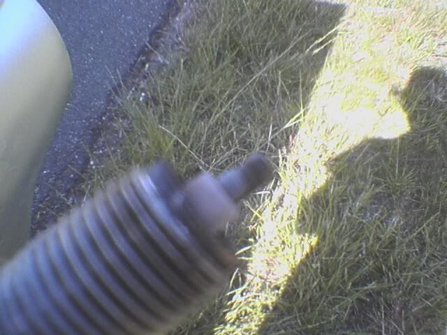

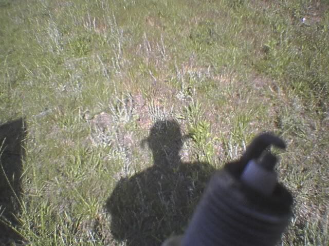

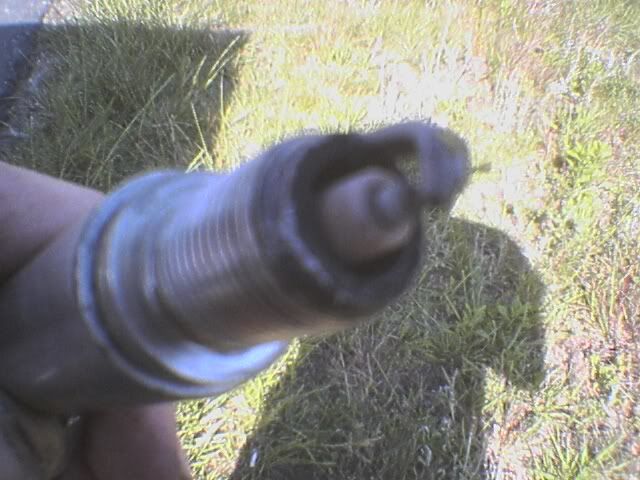

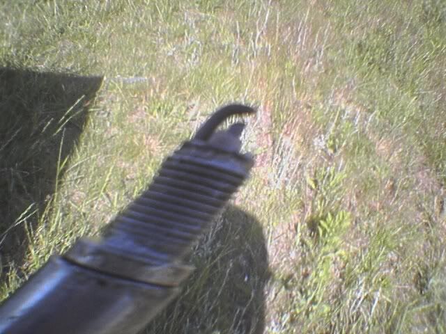

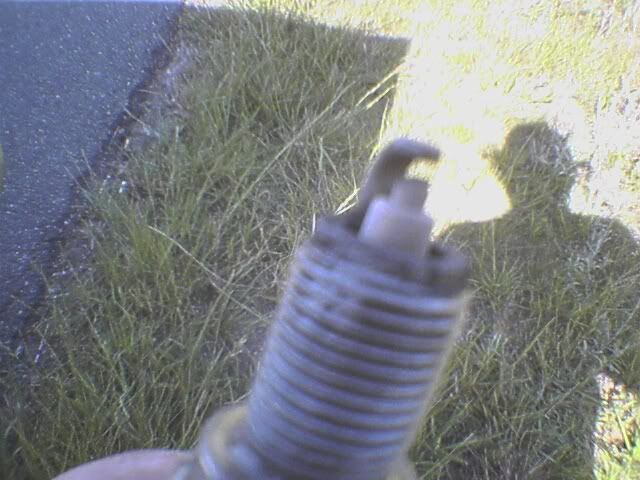

I got the plug today, well 5 out of 6. They look lean to me.
1.
2.
3.
4.
6.
I guess I need to fatten up the fuel a bit. From what I understand, I need to cruise the J-Y for some BBD jets, hopefully Thursday.
This last dist combo I put in it is a shorter heavy spring, and lighter weights. The pins are set for max spring tension. The weights are 54.7 and 55 grams. I think the lighter weights are causing some "flutter" in the timing, as the chain and gears have about 1100~1200 miles on them.
I looked during the plug check and I have Denso KJ20CR-L11 plugs in it now. What would a good plug be to run in this combo. DI I know you said you thought that the ZFR5N's would be a bit hot. What do you suggest?

Yeah looks a bit lean... you can shift the metering rods a bit and see if that helps (next you'll be needing the rods and jets out of a 318 carb... which may be a bit fat for the six)...
You might also try a set of stock plugs to see if color returns to them
NGK GR-4 (stock)or GR-5's (cooler)
That's one thing to think about in the whole 'economy vs. fuel' formula... if the mix is very lean it will ping... if you a fairly rich it will supress spark knock by pulling the extra heat out of the chambers with the extra unspent fuel...(as long as you aren't 'flooding it')
Almost there buddy!

Looks like you need stiffer step up springs to keep the rods up for a little richer mix.
Or switch to the NGK plugs so we can tell what is going on. I am not familiar with the Denso plugs. I am running the GR-4 and they run a light cinnamon color with a #58 jet.
