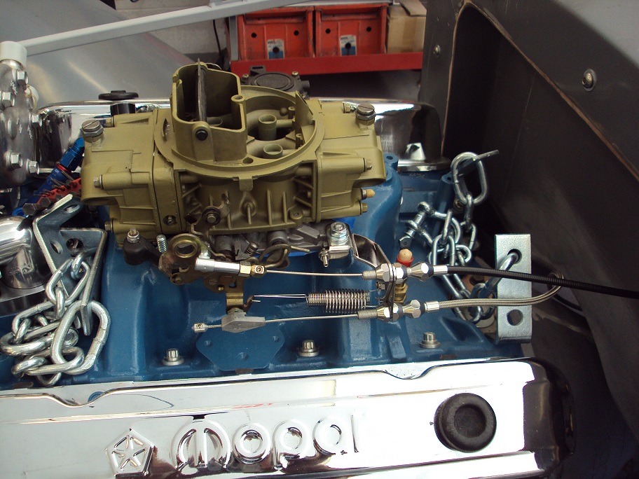

So I have a Super Six setup with a Carter BBD from a 77 Volare. Kickdown linkages are seemingly increasingly hard to find so I was wondering your guys opinion on this. Would it be better to get the stock super six kickdown or a Lokar cable? I have a 904 Trans if it matters. Oh, and what part numbers would I need for the cable and other brackets I would need? This is all on a 72 Dart Swinger. Thanks!!
IMO, Cable is the only way to go - and lokar makes the best. Smooth operation. No routing problems that linkage can cause, especially if you are running headers or other no-factory stuff. Infinitely adjustable. Here is the Lokar set up on my street rod ( 727). Steel jacketed cable in the pic attaches to the trans throttle lever. Only thing you have to duplicate from the linkage set up is the distance from the carb throttle shaft to the cable attachment point.
