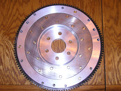

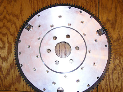

PostPosted: Thu Sep 25, 2008 5:20 pm
Joined: Tue May 06, 2003 5:53 am
Posts: 750
Location: Crestline, CA
I have received the AL flywheel from Wilcap.
It weighs in at 10 pounds, and is drilled for both the Mopar 9 inch clutch, and the Ford 10 inch variety.
The look and feel of it is very high quality. I can't wait to go put it on the car, hopefully tonight.

PostPosted: Fri Sep 26, 2008 6:45 am
Posts: 17634
That looks exactly like the one I am running on my '64 Dart that I got used (but only Mopar pattern). Must have been a Wilcap piece. It is probably 15 yrs old, and I've been running it in my Dart for about 4. Flawless so far.
Mine should get here next week.
Nice work and thanks again Greg M!!
