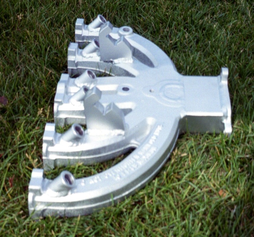

With my intake
http://www.projectplato.com/cars/Images ... oldend.jpg
I know the spray hits the bottom of the runner. What's the real negative effect, I'm not sure. This idea intrigues me.
Cheers!
Al T
 Post subject: Re: We're waiting . . .
PostPosted: Fri Mar 06, 2009 9:37 am
Posts: 24962
With my intake I know the spray hits the bottom of the runner. What's the real negative effect, I'm not sure.
There is discussion of the effects of (apparently) less-than-optimal intake manifold placement and angle of injectors in this SAE paper by Chrysler —see page 9, "Intake Manifold" section. If you take a look at Figure 17 (zoom in), the injector placement and angle on the Chrysler 2.2 & 2.5 MPFI engines looks pretty similar to that on your intake.

Those are nice pics and yes, the Chysler engnieers seemed to be completely okay with the injector angle. I liked the flat torque curve they were able to get (95% of peak torque between 1800 & 4400 rpm). Also having just gone thru the cam design process, it was interesting to see how they set up the turbo cam. In particular, intake opens at same time as exhaust closes, 8' ATDC.
There is discussion of the effects of (apparently) less-than-optimal intake manifold placement and angle of injectors in this SAE paper by Chrysler — see page 9, "Intake Manifold" section. If you take a look at Figure 17 (zoom in), the injector placement and angle on the Chrysler 2.2 & 2.5 MPFI engines looks pretty similar to that on your intake.
Thanks for posting that paper; it had a lot of interesting info in there. My Dart has similar injector placement and I'd been wondering if there would be much to gain (though I didn't expect there to be).
