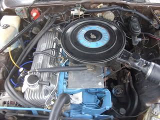

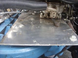

heres my heat deflector i made for the bbd super six setup,with a 4 dollar piece of scrap aluminim,a hole saw and cut off wheel, and it works great.
got more pics if anyone wants em.

1980volare,
Very cool! I bet your carb doesn't heat soak now! It sure made a big difference on mine.
