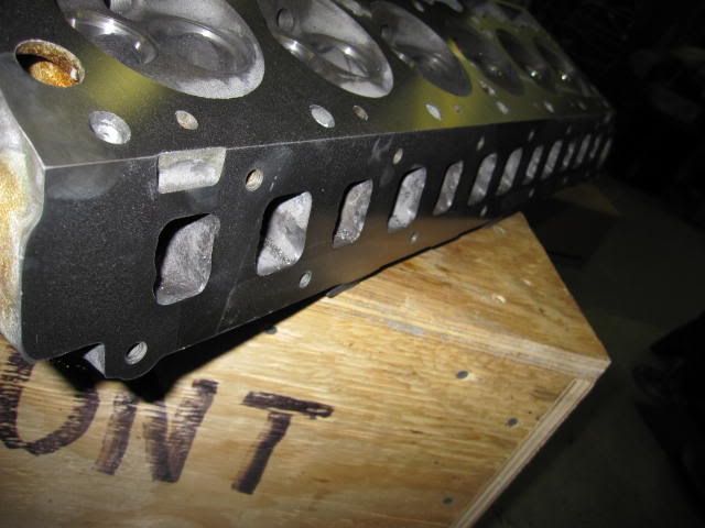

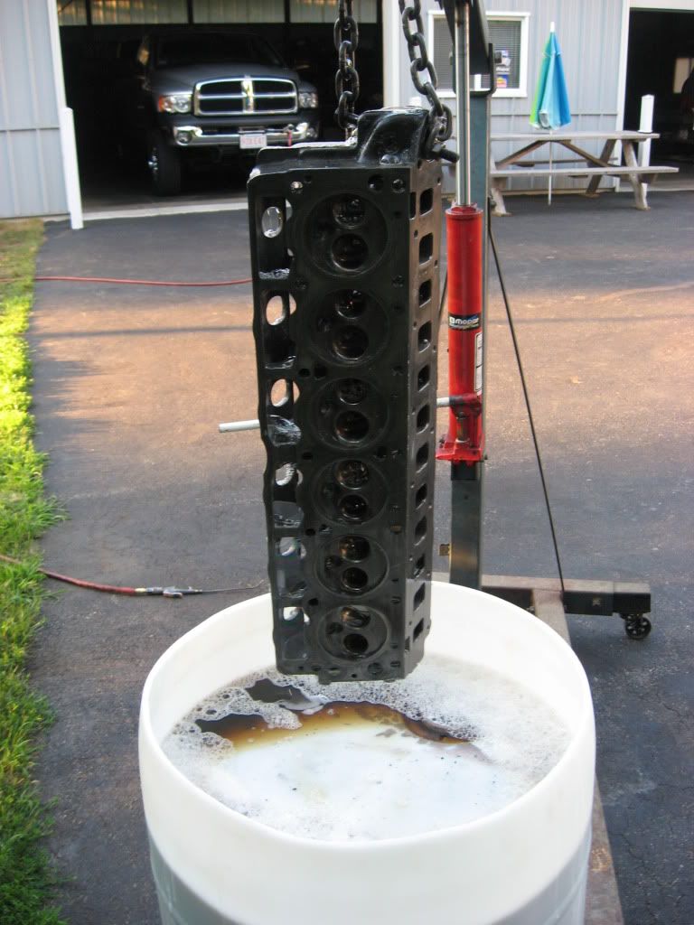

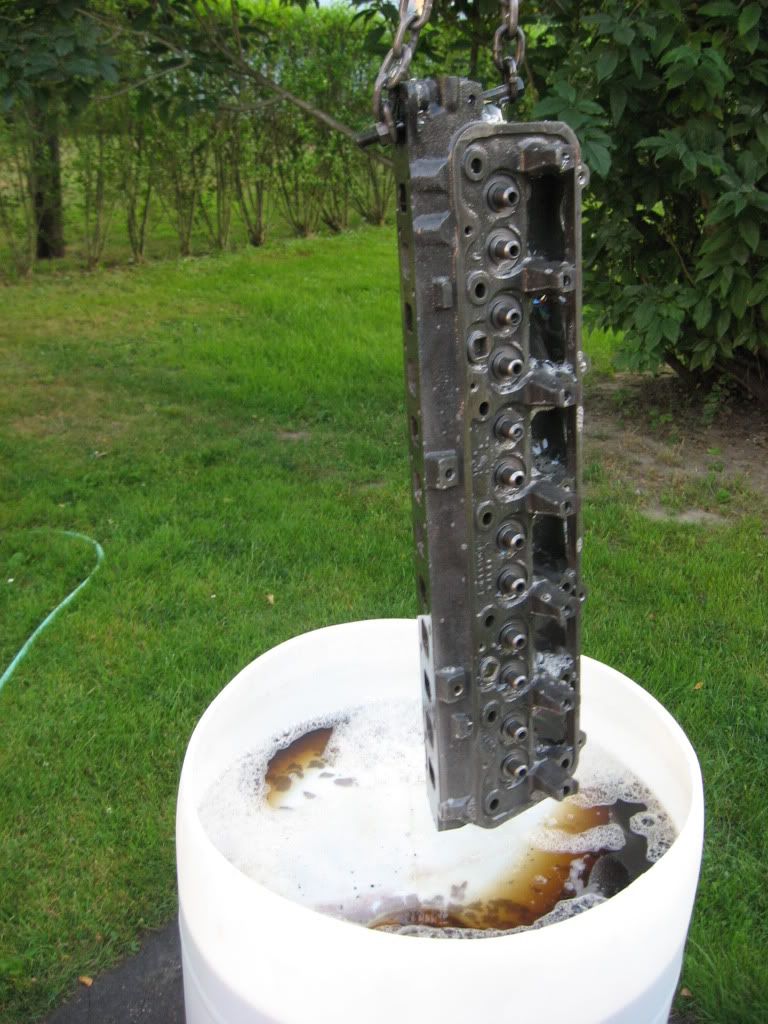

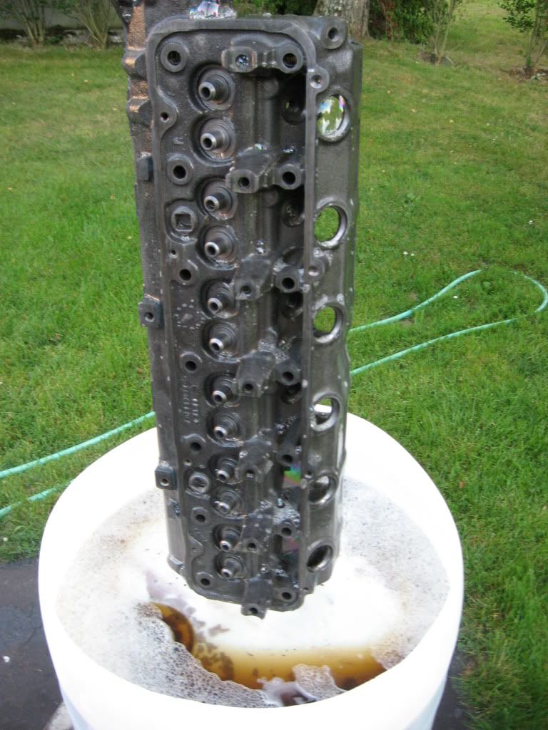

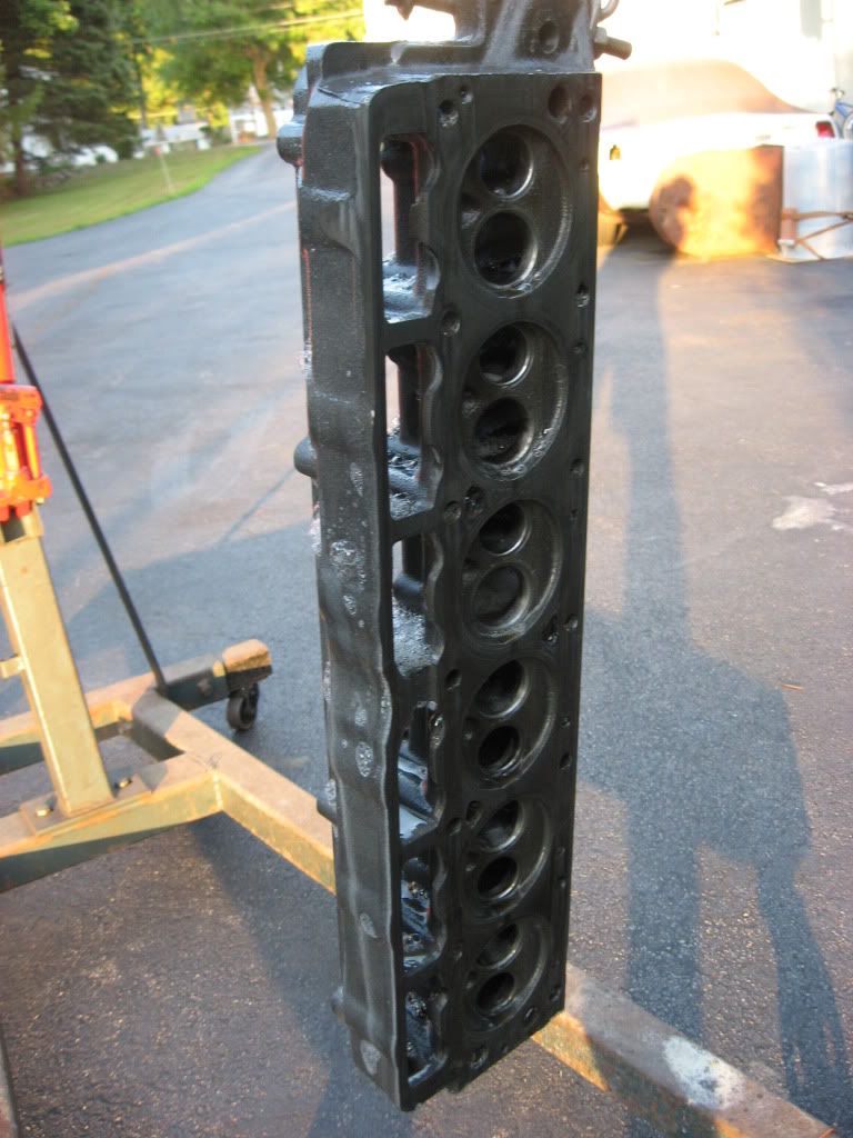

i really like how clean it came out. how did you go about drying it? drip dry? heat gun/heater? also as far as the ratio goes for 1 - 1 is that pure zep or zep with something else? also where can i get the rust remover you used ?

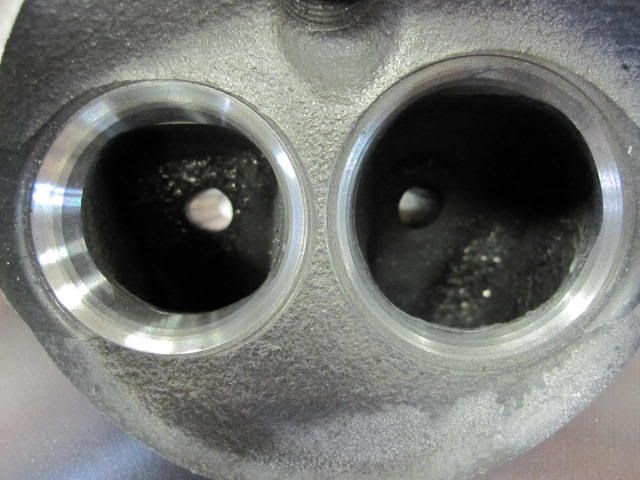

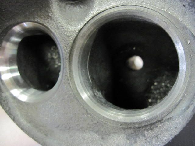

 Post subject: 50 cc heads
PostPosted: Wed Aug 04, 2010 7:45 am
Joined: Tue Aug 29, 2006 7:13 pm
Posts: 233
PostPosted: Wed Aug 04, 2010 7:47 am
Posts: 233
PostPosted: Wed Aug 04, 2010 7:48 am
Posts: 233
PostPosted: Wed Aug 04, 2010 8:09 am
Posts: 233

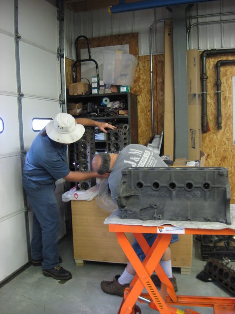

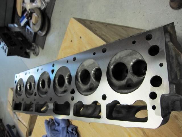

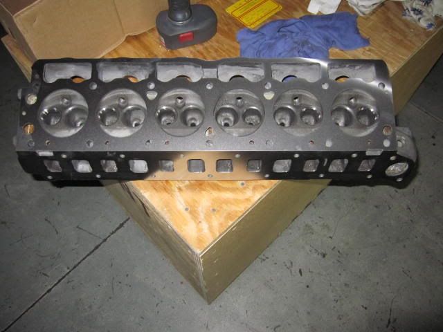

bob, in the pic with the power wagon , i let the parts drip into the drum and use the air hose to blow out any holes and quickly go over the entire part. the zep only eats rust and has other chemicals mixed into it. order it from a zep salesman. the 40 cc head is on the left in the pic with machinist. the 60 cc head is on the right,now 50cc. i also had intake and thermostat face machined to true and get rid of pits and sins.
PostPosted: Wed Aug 04, 2010 9:07 am
Posts: 233

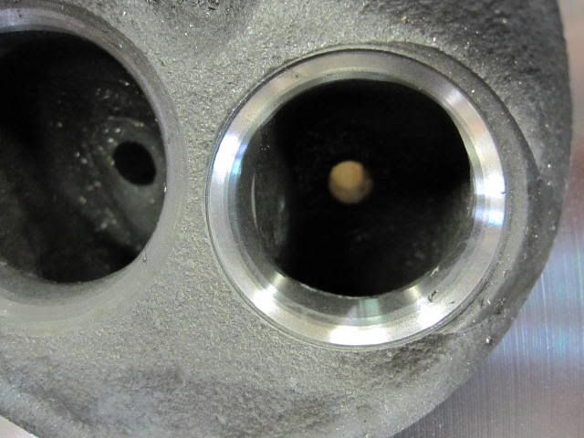

the tops of the guides have not been cut down and the bowls are not bowl hogged yet .

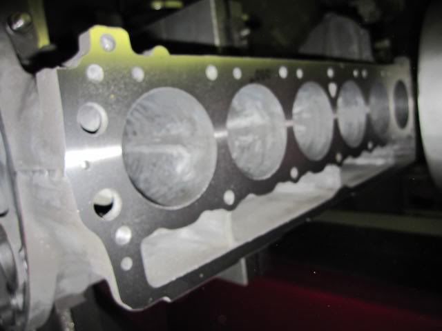

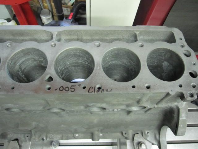

 Post subject: bh block decking
PostPosted: Fri Aug 27, 2010 9:55 am
Posts: 233
 Post subject: block decking
PostPosted: Fri Aug 27, 2010 9:59 am
Posts: 233
