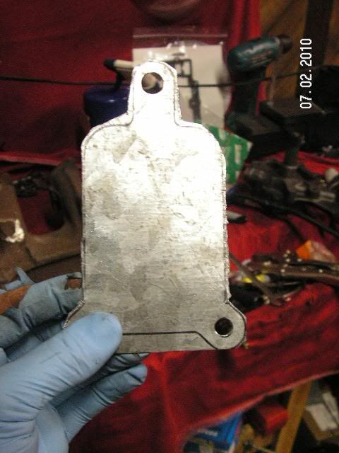

its appreciated DI but i got it covered, little sheet metal, some jb weld, 2 intake/exhaust mani studs 2 nuts and one misc bolt, 2 spacers ( one was from a chunk out of long spacer for my rear sway bar end links, the other was a 5/16 tube nut)

Does your set up include heated air for the air cleaner?. This will help with cold drivarbility. I think it is a part that bolted onto and around the stock exhaust manifold.
I think your block off plate is a good start, but honestly is too thin to last. It is so much trouble to take off that intake exhaust/combo, I would encourage you to take your sheet metal plate to a machinist, or metal worker and have a 1/4" plate made as Joshua recommended. It will save you much time in the long run. Your back will thank you for it. :wink: Not only that, but if you put a thicker plate in there, you will get the needed heat transfer to make life better in the cold weather.
Good luck, Sam

Also a quick note. Watch out using Galvinized metal. The burning product can kill you.
Just my 02.

The fire rating for that thin of sheet metal is about 1-2 hours...The fumes from heated galvinized( the zinc) will make you sick and send you to the hospital (in my trade you have to wear a filter mask and a welding hood to weld on it).
From previous experience with bolting on plates to use with the Dutra split manifold I would shoot for 3/16" plate, and if you mix is OK you can use the Bronze RTV...JB weld I think holds up to about 300-350 degrees (exhaust is in the 4-500 range if tuned...and up to 1000 if you are reallly lean).

well i know about the fumes from galvinized steel, but this is just a patch, I have header flanges (off ebay) on order, I have a buddy of mine swinging by today and I will got get raped at home depot for some sheet steel, it was me just seeing if it #1 i could do it, and #2 if it might survive engine break in, but i will fix it once i get my sheet steel.

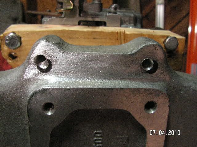

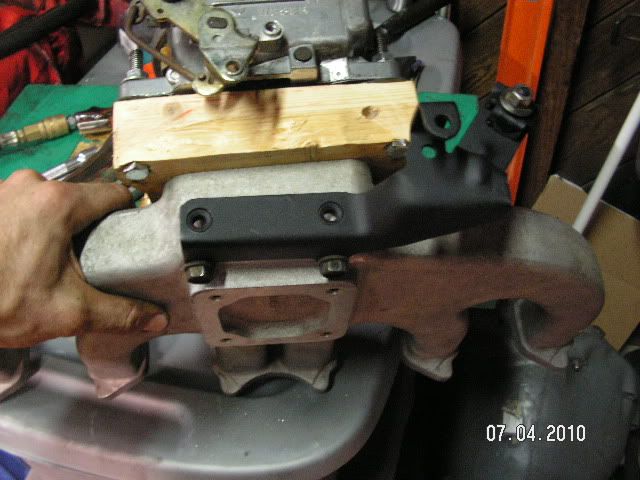

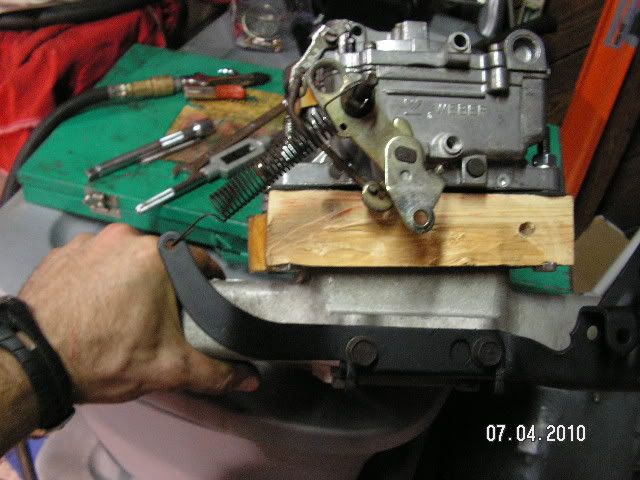

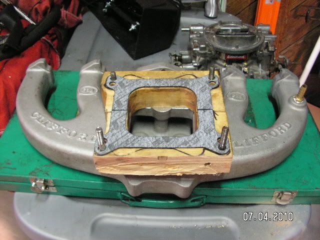

working on a 2" spacer as we speak (i know kinda thick but the wood was free lol) since my cliffy came with no carb adapter I got to engineer one !!
also I have a edelbrock 1405 series carb (it was also free :D) now my 2 questions are can i get rid of the AUXILIARY VALVES & WEIGHTS #42
http://www.edelbrock.com/automotive_new ... 0/1477.pdf
and can i make all 4 barrels open at once VS front 2 then at half throttle rear 2 begin to open ??
-Mike
I am the Guardian, I hate helos, everything leaks.......

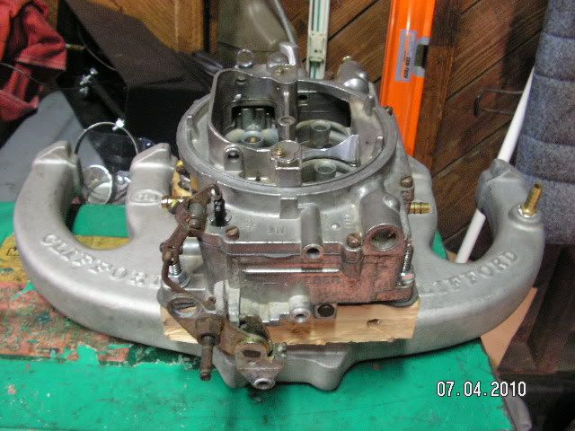

update heres my carb spacer, total time to make 1.5hours ( most of which was drying time for the glue)
-Mike
PostPosted: Sun Jul 04, 2010 5:41 pm
Joined: Thu Nov 05, 2009 6:18 pm
Posts: 187
Location: Midland TX
Be sure to use a gasket on each side..........I've been doing these wood spacers for years and they always work perfectly. I even ran a 9:93 with wooden spacers on a tunnel ram. I'm old school, really old school. I'm surprised someone hasn't tried to tell you differently. Make sure it's flat!
MaX

PostPosted: Sun Jul 04, 2010 6:20 pm
Posts: 1195
I like that spacer! 8)

PostPosted: Sun Jul 04, 2010 6:27 pm
Posts: 187
Now he has the makings of a REAL hot rodder. No parts changer at home here........... :D

PostPosted: Sun Jul 04, 2010 8:02 pm
Joined: Sat Aug 11, 2007 1:17 pm
Posts: 776
Location: Jacksonville, Fl
cheapest spacer i could find THAT WOULD work but still need to be modded-------$29 (1"alum)
mine--- 2" wood with the correct bolt patterns (wood was free $4 for the 5min epoxy) total $4
Free edelbrock 600cfm carb
carb rebuild kit w/free marine accelerator pump seal $21
getting it running before i die...... PRICELESS lol

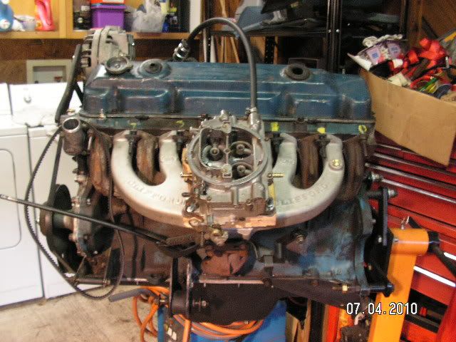

UPDATESSS !!!! well i had to stop started messing stuff up oh yea it ws also 630 in the morning.......... i started working on her at 6pm an and off till about 8pm then hard charged throught the rest,
now off to finish her,
-mike

looks like it'll work .................now for a nap eh?
