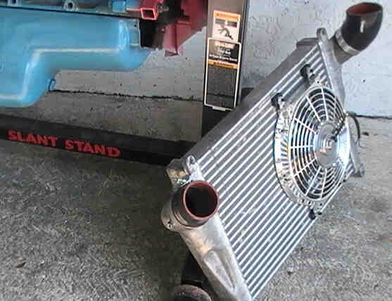

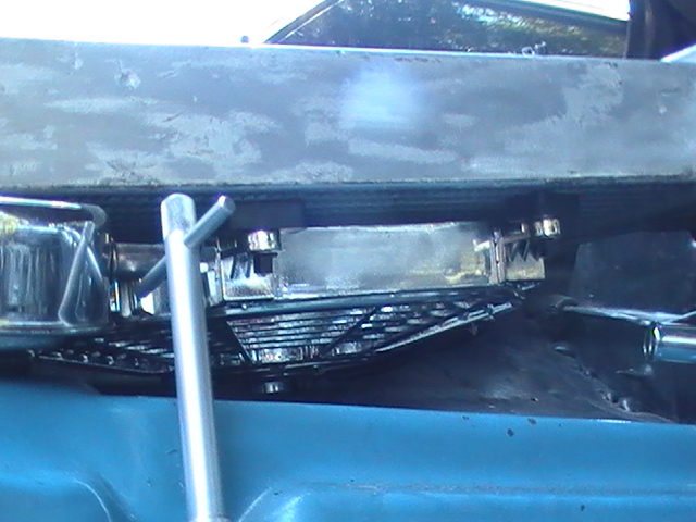

Your intercooler placement is interesting. Is that an electric fan hanging on the underside? You'll enjoy what the pressurized slant can do!! :shock:

Yes it is a fan that is thought it would help when not moving.
I new someone was gonna say something about where it's placed. Did not think it would be you tho.
Yes I call it the no cut car install. No cutting up the ol teekie.
Now that it,s done this way? If turbo brakes, I could easily remove from carb hat to the head in about a 1/2 hour. Install open headers and finish the night on the motor if needed. Hope I don't have to do this now that I said sumthin.
Didn't say there was anything wrong with it, just interesting. I went 10.90's with mine on top the motor. Later

Hay Ryan. Didn't think you did, I got the idea from your car and the turbo kit I was going to buy, showed it mounted where yours was. Bought the cooler used, just happen to be the right size for my application:!:
