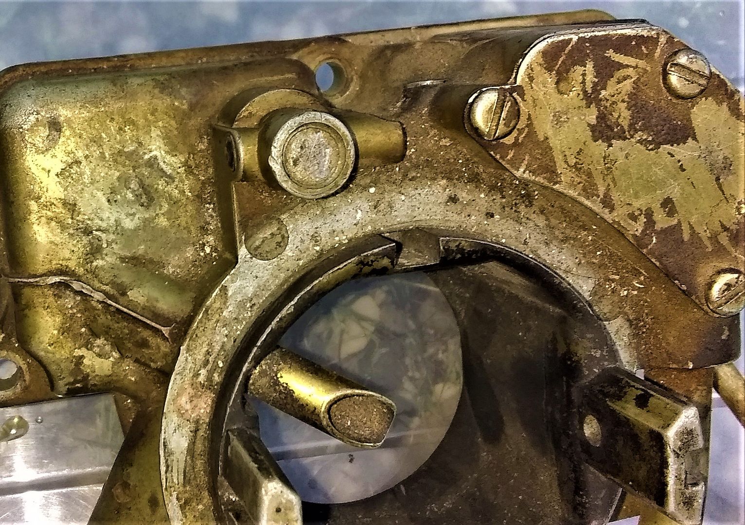

Power valve adjustment screw is covered by Soft lead plug easily removed with small screwdriver Image

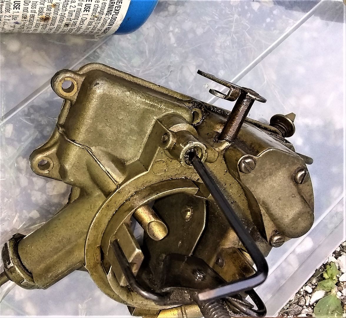

PostPosted: Tue Oct 20, 2020 6:22 pm
Posts: 1603

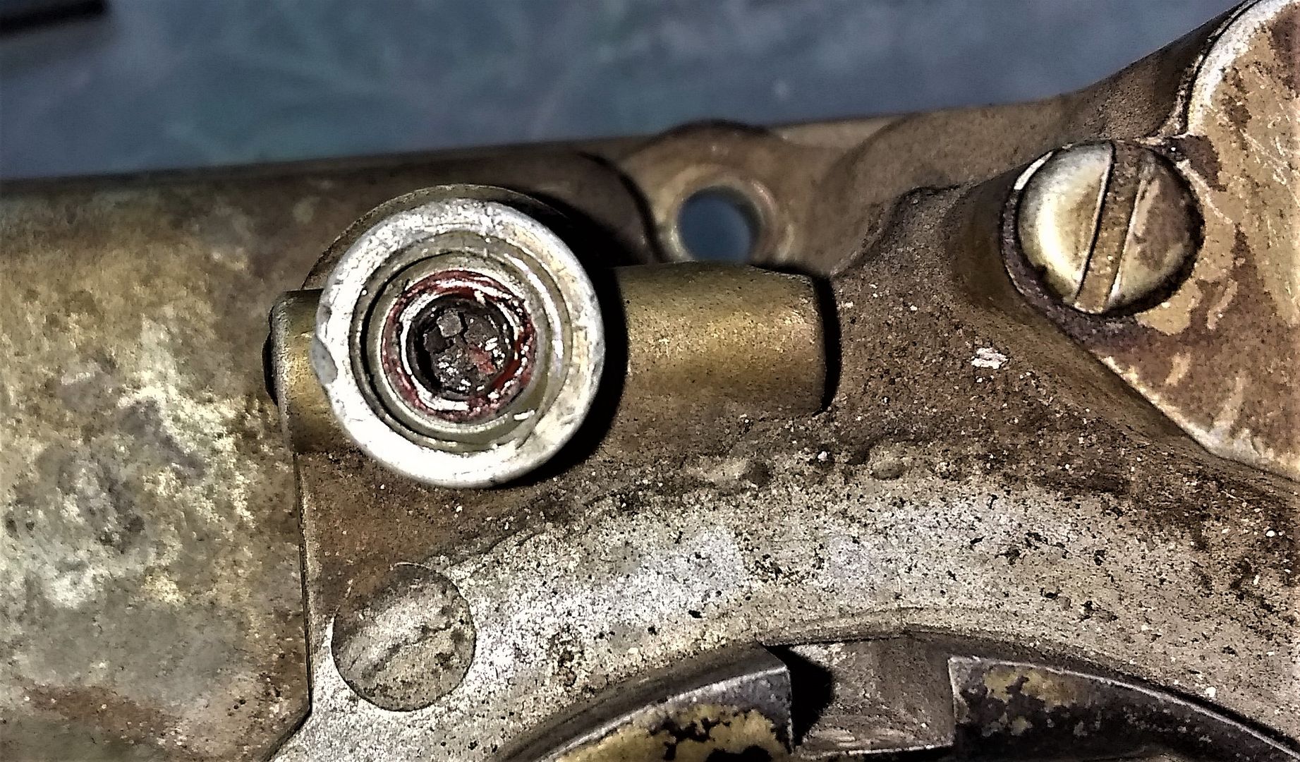

Under that led plug is a 1/8 Allen head screw

PostPosted: Tue Oct 20, 2020 6:26 pm
Posts: 1603

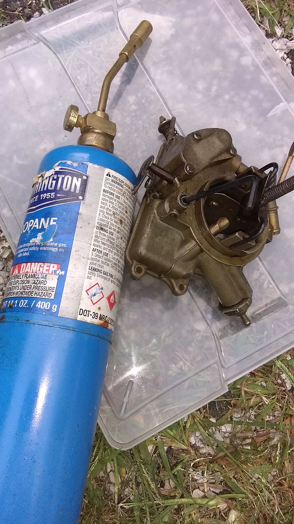

Screw is held tight by some sort of Loctite heat will be required to loosen up the Loctite 15-20 seconds usually does it/ but if doesn't turn really easy , more heatapplImagey more heat without heat it will strip.

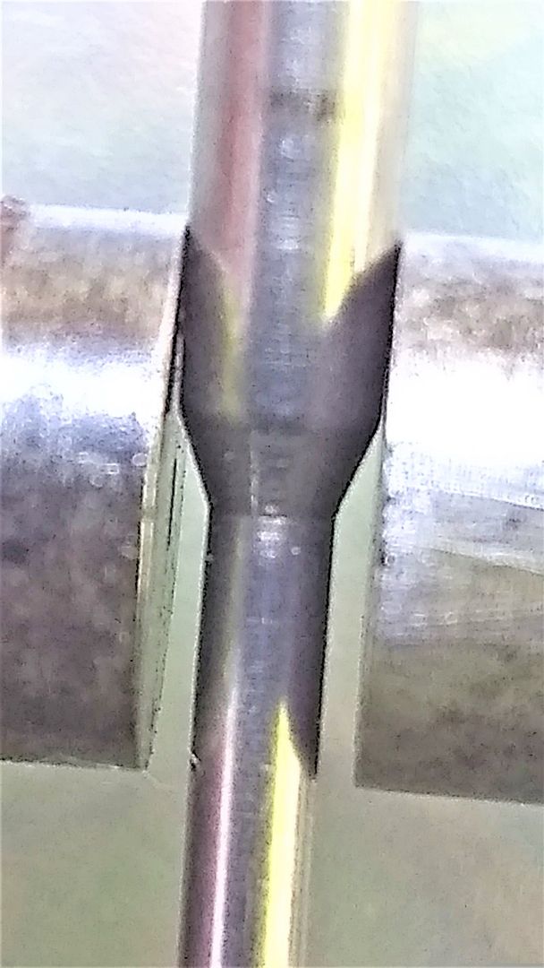

PostPosted: Mon Nov 02, 2020 1:21 pm
Posts: 1603

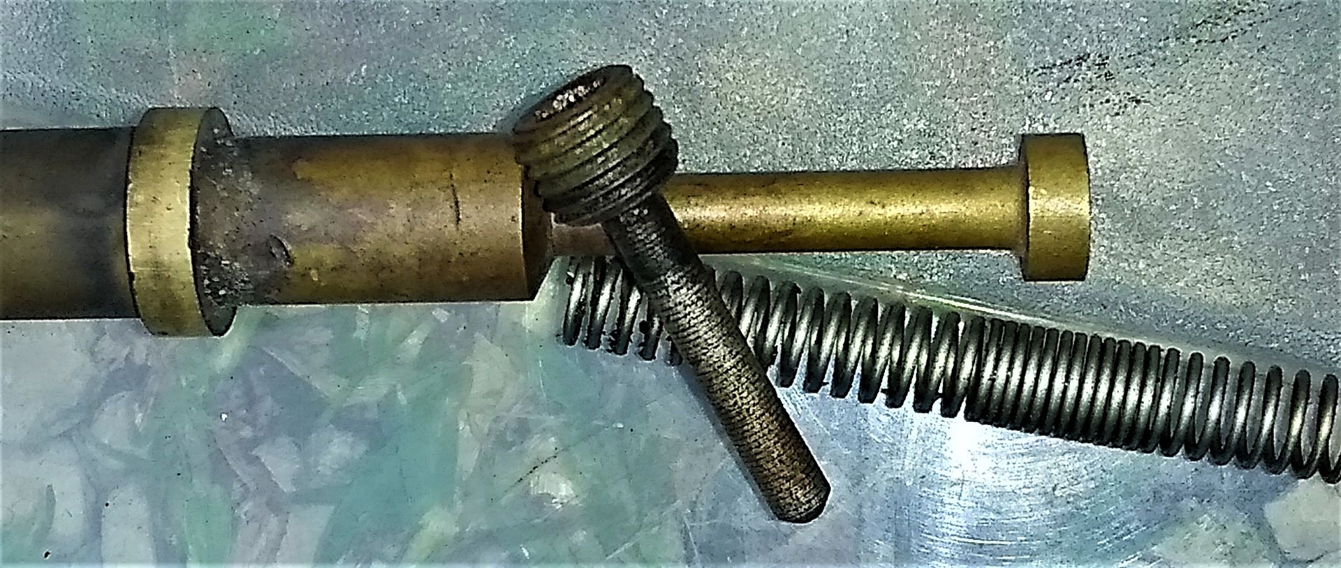

Image it's a taper type arrangement.
PostPosted: Mon Nov 02, 2020 1:26 pm
Posts: 1603

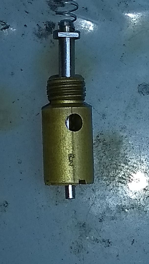

Fits in this brass pieceImage

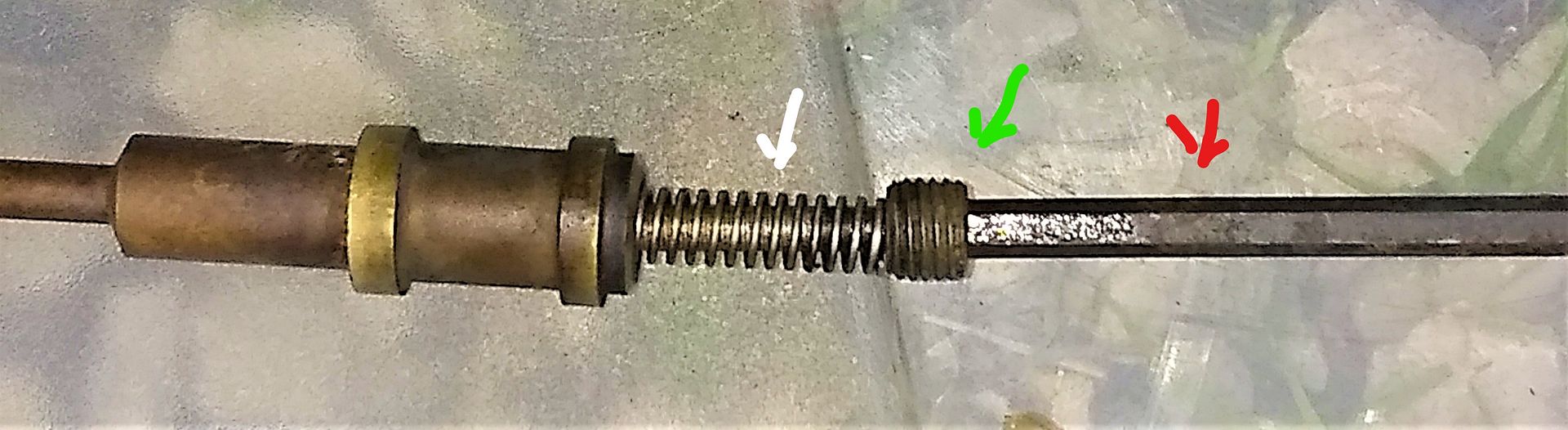

PostPosted: Mon Nov 02, 2020 5:23 pm
Posts: 1603

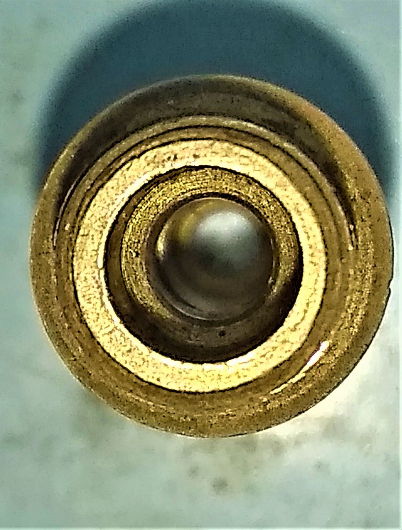

White is spring ,green is Allen head screw red is Allen wrench. Turning clockwise should increase tension on Spring

Weak spring and or stuck piston could lead to slow or non activation of power valve
