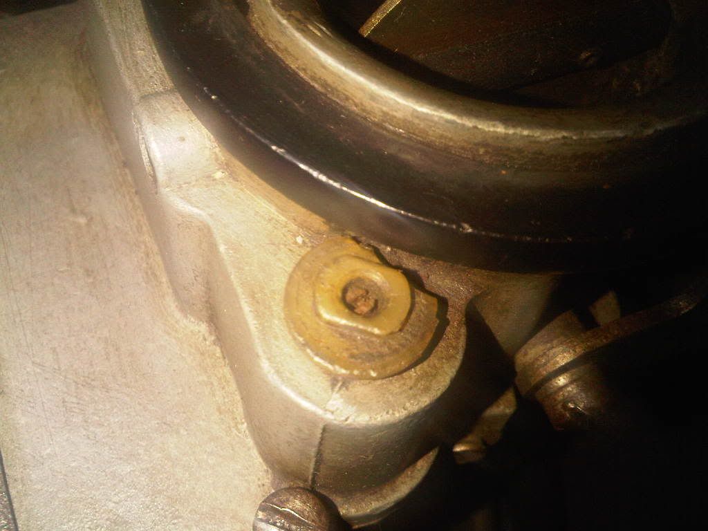

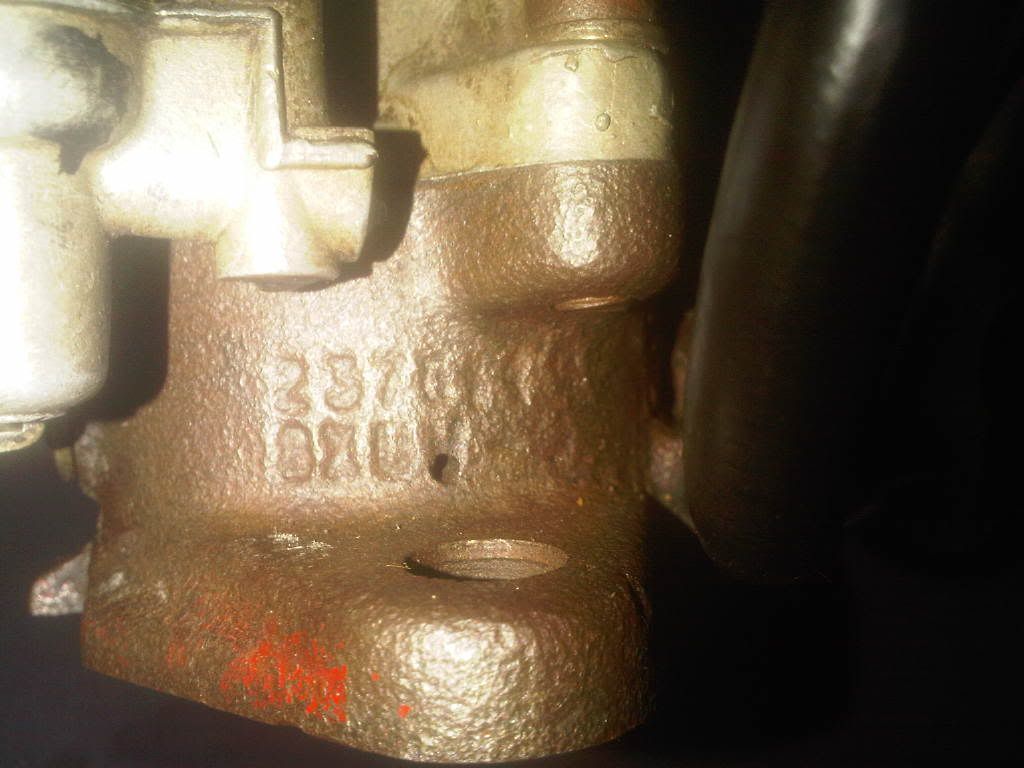

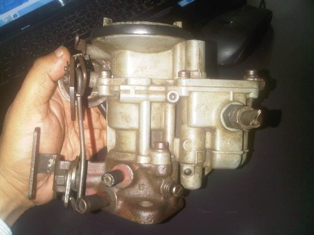

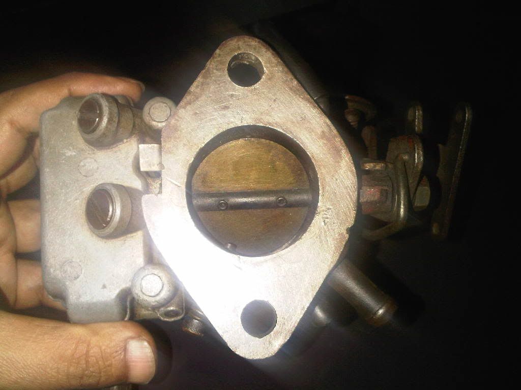

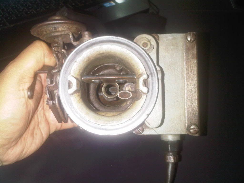

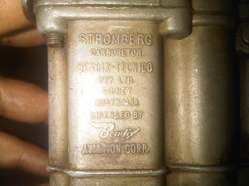

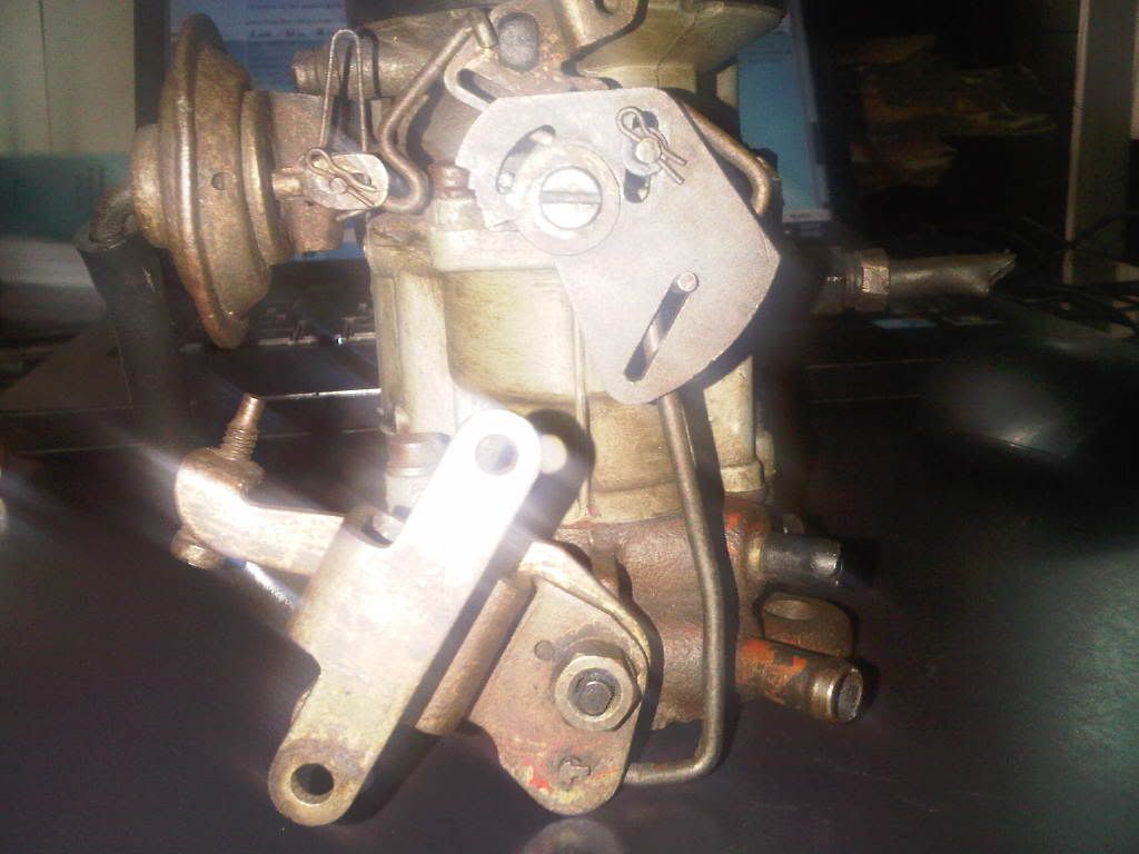

Dear All, finaly today i got the carb as suggest by Dan BXUV-3.
posting some pics of carb before cleaning
http://s1147.photobucket.com/albums/o55 ... 88758a.jpg
Keep pressing next you will all the pic.
i dont know how my pic will come to this page directly ???
Chuck can you help in this.
PostPosted: Tue Sep 04, 2012 10:37 am
Joined: Mon Aug 27, 2012 7:07 am
Posts: 58
Location: Pakistan
Image[/img]
PostPosted: Tue Sep 04, 2012 10:42 am
Posts: 58
Location: Pakistan
some more img
can some one send me the exact Air Horn gaskit image thanks. STOP make carb cleaner and Karoseen for cleanng carb. in Pakistan no special carb cleaner except STOP make . is ther any home made solution may i can try?

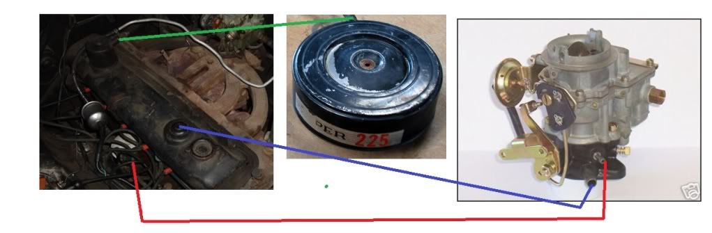

Can any one help with the connection of this carb. carb is rebuild and working very good on idle speed but once accelerate engine strave and dies. may bee my piping is wrong?
PostPosted: Sun Sep 16, 2012 9:08 am
6 Pack Dart
Posts: 2281
Location: Eugene, Oregon
The hole you have in red is for the pcv to go into and that goes onto the carb big tube with a gas proof hose. The other part at the back of the cover is to go from the air cleaner with another hose.
Richard
Part of Tyrde-Browne Racing
PostPosted: Sun Sep 16, 2012 9:27 pm
Posts: 58
Location: Pakistan
Is it Okay now?
PostPosted: Sun Sep 16, 2012 9:52 pm
Posts: 3767
Location: Black Diamond, WA
You should be good to go....enjoy!
