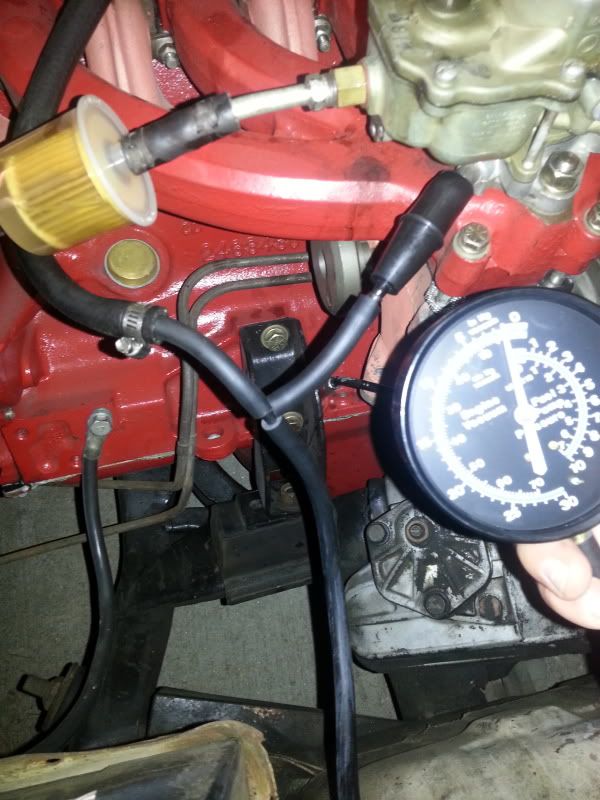

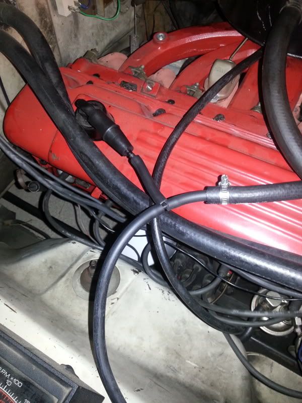

Ok i teed into the pcv. Two different ways with two very different readings. Confused on how it should be done
Pcv disconnected completely: 19"
Tee'd into pcv at valve cover: 13"
Tee'd into pcv at carb: 1"
Here are pictures of how i done it (unsure how exactly it should be done.)

Teeing into the pcv isn't ideal. You need to find a better place to measure. The Positive Crank-case Ventilation system is an engineered vacuum leak to provide sweep air for the engine.
Reed suggesting tee-ing in at the choke pull-off. That would be better.
If you haven't found true manifold vacuum yet, and you don't have the tell-tale miss, leave the valve lash where it is. If you are getting the periodic "Poof" out the tail pipe, then loosen them up. OCG and Erson both spec too tight lash settings.
Patrick; The #125 is a mechanical cam. Hydraulic slants don't have adjusters. I disagree with Josh on that grind. That's the first time I've found anything to disagree with him on though. :shock:

PostPosted: Sat Oct 27, 2012 10:41 am
Posts: 13278
If you have no other options, tapping into the vacuum at the #6 runner is better than checking vacuum via the PCV line. However, sourcing your vacuum signal in any one intake runner will lead to a fluctuating vacuum signal.
You must have a 60-63 Carter BBS if you don't have a vacuum operated choke pulloff diaphragm. Use your vacuum gauge to find a port on the carb that has vacuum at idle.
