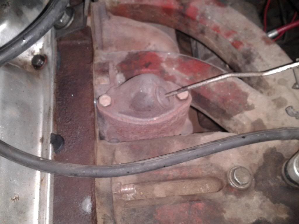

Im sure bronze is the only way to fix it forever.

Here are pictures of the choke pocket, If needed I can take one without the cover, just did not have time to take it off when I did this.
And here is the crack
66 Plymouth Valiant 2door. Slant 6 225, 3speed
PostPosted: Mon Jan 14, 2013 7:36 pm
Joined: Wed Sep 20, 2006 7:00 am
Posts: 65
I had a very long thin crack in my exhaust, just below the intake-exhaust joint... We melded it like I said above.
I have seen many stock exhaust (6 to 1) cut in the midle in order to make a 3-1, 3-1 exhaust, and the hole is perfectly melded in bronze.

PostPosted: Mon Jan 14, 2013 8:58 pm
I think I might have one of those with the partial choke pocket...
Let me check under my bench at my shop tomorrow after work...
Will be much cheaper than welding you old one...
-D.Idiot

 Post subject: My bad!
PostPosted: Thu Jan 17, 2013 5:40 pm
:oops:
I almost spaced this, yes I have one of these style manifolds with the partial pocket in intact shape, but...:
1) All the bolt holes have been reamed out, so for the exhaust pipe and outer 2 bolts you would need to du a full bolt and nut combo to get it together. The inboard stud hole is in good shape and I have a brand new stud to install in that location.
2) After getting the stack together you'll need to have it surfaced to make sure it's flat with your intake.
3) The previous owner of the stack decided the torch out the riser flap...so you'd need to do a transplant or do without and plug the holes with bolts.
4) The good news is I have stock stack gaskets and a remflex gasket I can throw in if you decide you need this manifold depite the above.
Let me know if interested,
-D.Idiot

Its alright I understand haha.
If the manifold will work then I need it :D
