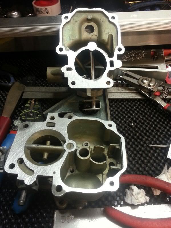

My Carters take a ride on the stationary belt sander to true up the top of the bowl, and the bowl top. Set them together without a gasket and look for the gaps.
I can see why, I have pretty large spaces when mounting the air horn to the main body. I'm not sure what to do, it's not even close to sealing with the gasket. Can I use copper RTV for a bit until I get the real fix?

on my supposselly "bitchen 60's rebuild carb" i bought with a sloppy shaft i needed to get fixed, also had bannana shapped top. i had to put it on a peice of glass and sand paper, took me a while, but all the sealing surfaces are 100% flat. a few ears were too far down to go any further.

If the surface looks uneven, you can use a smooth/flat block of wood with sandpaper wrapped around it and move back and forth with even strokes to get it flattened (if you feel your motion is uneven- sand the surface one way for 2-3 strokes then flip the body around 180 from the previous position for 2-3, and so on until it's "even".

This was on peice of glass and sand paper taped to it. Trick is circular motion and spin the part 90 degrees every so often for best finish.

Sorry for the delay with an update, I had a hectic weekend trying to find the daylight to get everything working. I honed the carb with 120 grit pretty well. It was hard to just slap the air horn on the paper since there is a part that sticks out over the accelerator pump slot about .25" passed the face that meets with the main body. The resulting material loss meant I needed 2 shorter bolts which I got from an Ace Hardware. I got the carb back in just before sunset last night. Unfortunately I had a hard time adjusting the idle by ear and decided to not take the car to work.
The glass is a good idea to test for flatness, I wish I had a pane around to test it on.
Nice visit today, hopefully you retained some of the download...
It was a nice visit, thank you again for the help! I did just this with 120 grit, I am pretty sure it worked. An employee at Knecht's told me I could spray carb cleaner or starting fluid at the seals to see if the RPMs jump, indicating a leak. I have yet to do this though.
