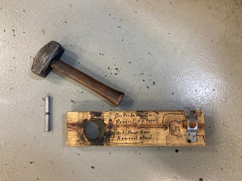

to remove slant six oil pump gears I have a section of sturdy 2x4 with a through hole cut into it that will accept the internal pump rotor.
remove the oil pump cap and gasket and outer rotor, set the oil pump body on the 2x4 with the inner rotor positioned over the through hole,
and using a steel drift and a three pound hammer, drive the oil pump shaft through the gear, I do this job with the 2x4 on the garage floor to maximize
the hammer shocks. A couple of good hits and you are done. I have used this procedure on cast iron and aluminum oil pump bodies with no issues.
This process keeps the removal force centered on the gear and away from the gear teeth edges.
The same piece of 2x4 is also a fixture to rotationally position a replacement plastic distributor gear.

PostPosted: Thu Aug 20, 2020 9:30 am
Posts: 13431
Very interesting tool. I will keep that in mind if the puller I got doesn't work out.
PostPosted: Thu Aug 20, 2020 3:11 pm
So rather than wacking with a hammer, just put your tool in a press..........
PostPosted: Thu Aug 20, 2020 7:15 pm
in a press
I was speaking to the unfortunate few like me that do not have a shop press.
For those that do,, press.
