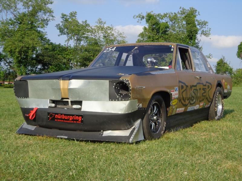

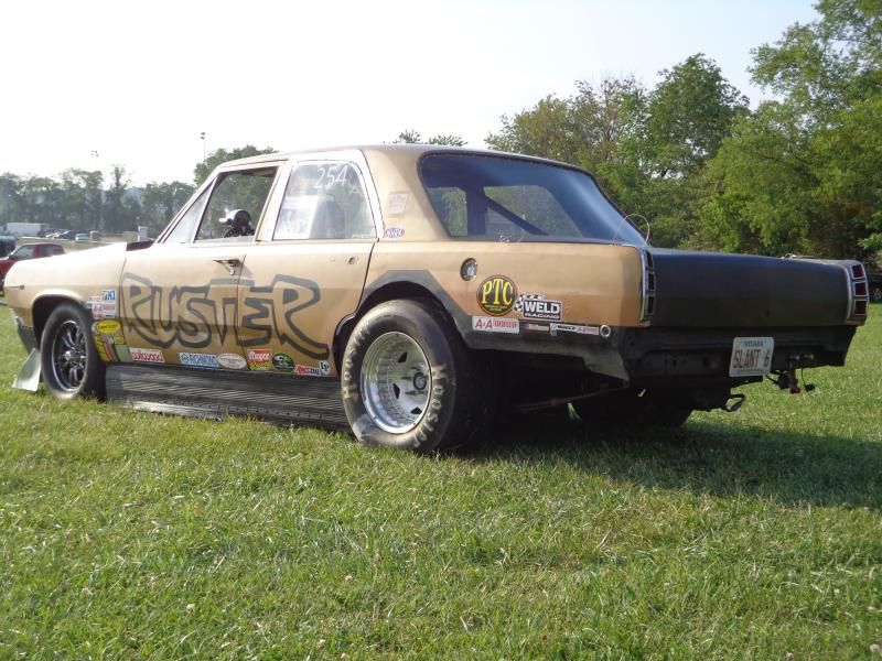

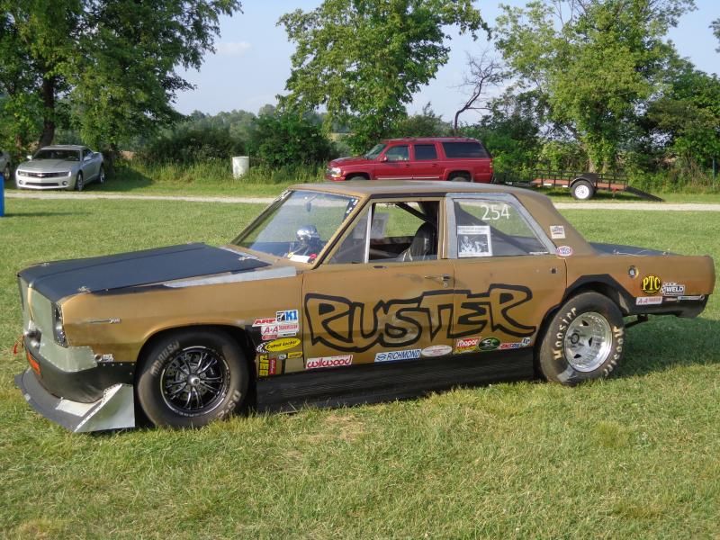

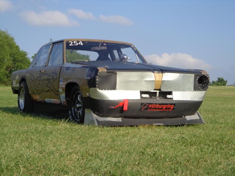

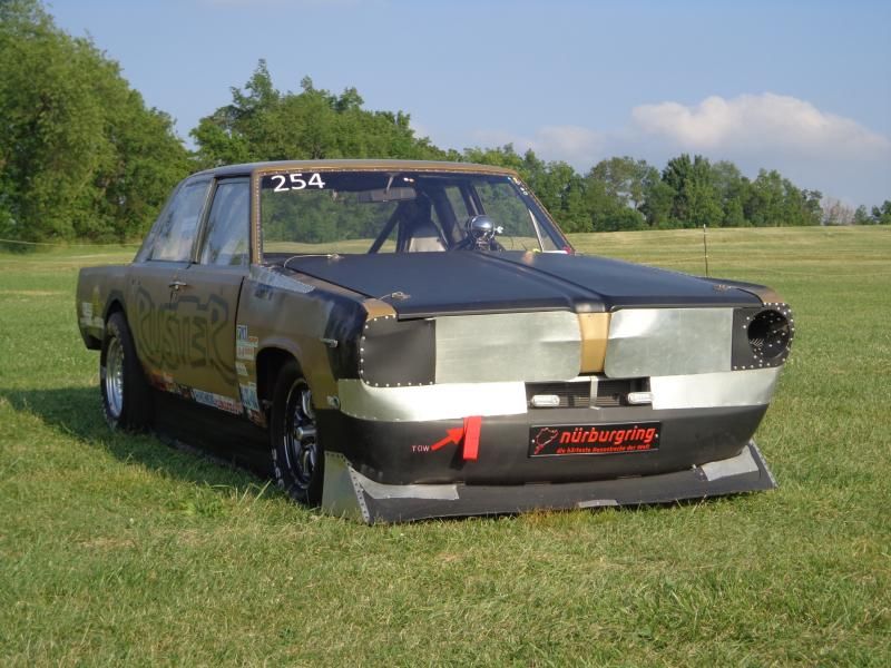

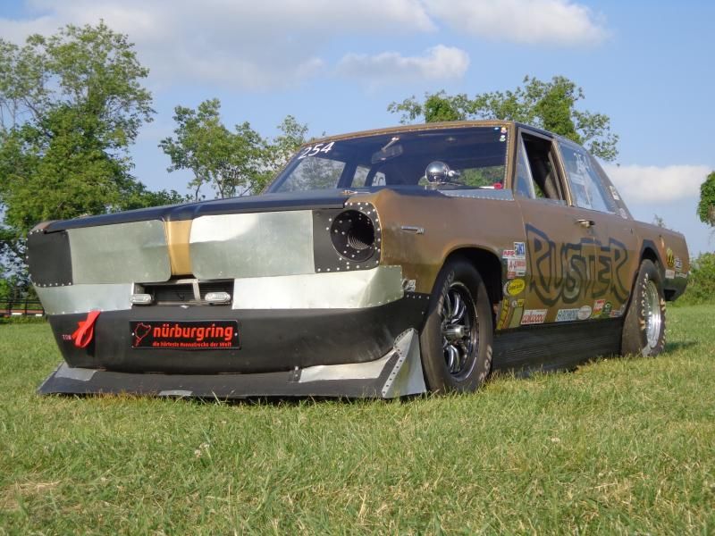

Its' Not a street Car but Here's my $.02
I still have more ideas on Wheel openings, and Belly Pans - Just need time to fab em alll up :-)
Also See how I did this in the Ruster Thread:
http://slantsix.org/forum/viewtopic.php?t=36132
HAppy MPG'ing..
Greg that looks like an "Aluminized Brick" :lol: :lol: :lol:
But a very fast one!!

Greg you will need to change the name if you cut out all the rust.
Seriously, my reading says raise that air dam an inch or two and put a flat bottom on it that extends back well behind the radiator core, about to where the wheel cut outs are. The air flowing under and along the flat surface creates low pressure which pulls the car down at speed, and seriously enhances stability.
The big challenge is getting the air around the front, which is very flat, and back together in the back, which is also very flat. Look up Kamm-back. I think that is how it is spelled. I would add a spoiler of that type to the rear.
As far as the front is concerned, why not make the front curved in the up and down direction as Will has. This seems to be the ticket with a slab front car. Don't take me wrong here, I think your craftsmanship is super. Just another thing to try after you have gotten the numbers on this one.
