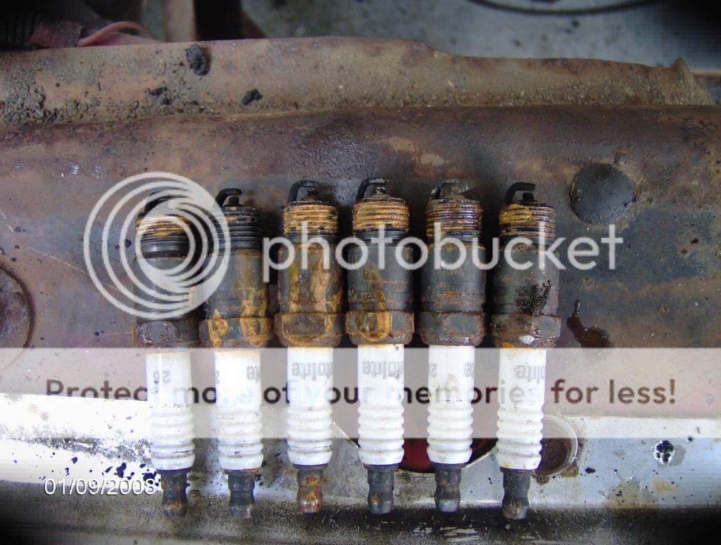

Broken rings or burnt piston will not leak out carb or exhaust. I'd say you need to pull the head at this point. Valves can stick if they are crusty in the int/ex runners even if guides are good. What did the plugs look like? were they in good shape / oily / crusty / damaged? That could give a hint what's going on in the cylinders.
Hello Nutty, here is a picture of removed spark plugs, left to right cylinder 1-6
Not sure how relevant this might be at this point but there they are, I notice that this # 2 piston top is very clean compared to others, others have some carbon build-up but this pistons carbon was removed very easily with a swipe of a paper towel, do not know what to make of that. Am going to go out and further investigate things.
